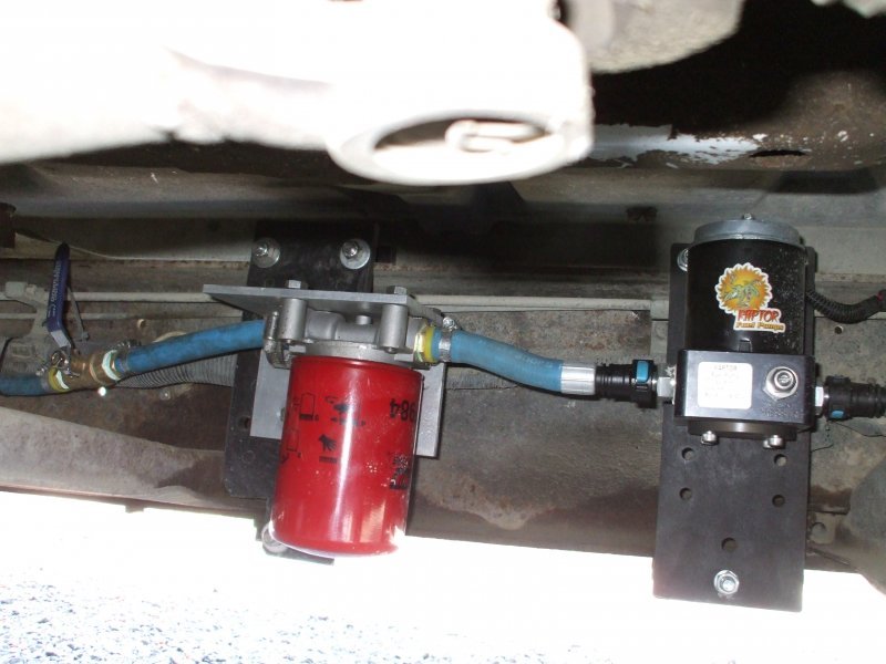

Because mine is doing the same thing. Im thinking its a leaking o ring in the FFM. My truck was doing the same thing, so I replaced the FSU and the fuel line from the FSU put a shut off valve in before my pre filter and then a raptor 100 LP and bled the line to the FFM and it fired rite up. Took the truck camping and parked it on a hill facing up hill and closed the shut off for the weekend.After the weekend was over, I opened the shut off and it fired right up. Went back the next weekend and parked the truck the same way but didnt use the shut off, and couldnt fire up the truck even after bleeding the fuel line to the FFM and t-valve. Had the truck towed by a friend next to me to the top of the hill. I turned the key and cycled the GP and it fired up. There is air getting in the line somewhere, I dont see any leaks but that doesnt mean its there. Going to relocate the FFM and run all new lines today and see if there is any change. I hope you Found your issue. I know first hand how frustrating it can be.
