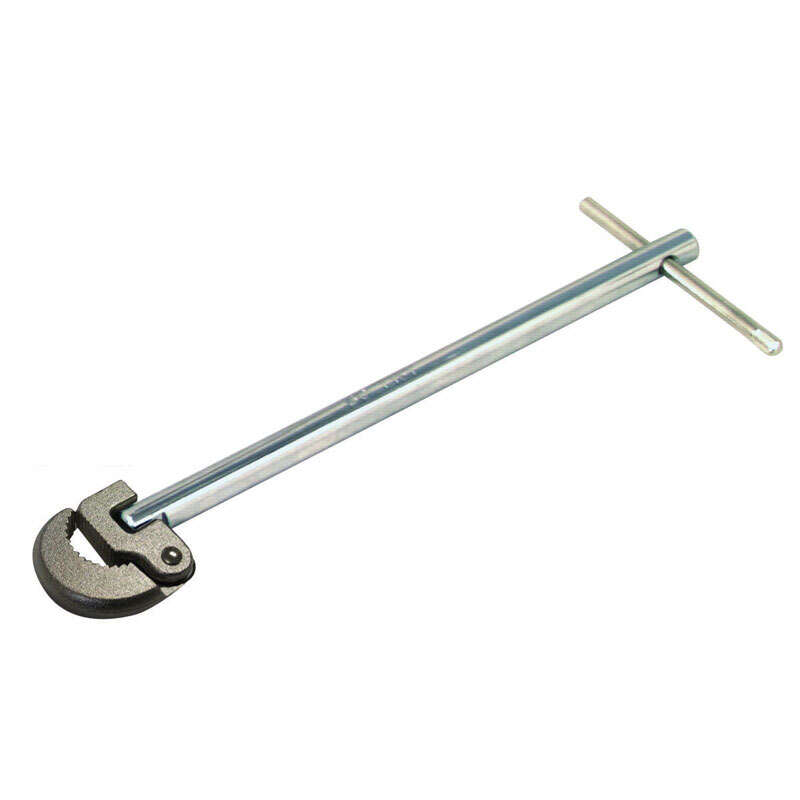

Loosening and tightening the OPS is a real joy if you don't have the correct socket. One technique that worked for me is a basin wrench. A lot of 1/2 and 1/4 turns but, it worked without damaging the switch.
