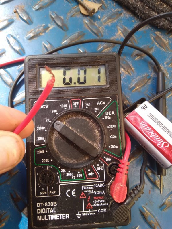

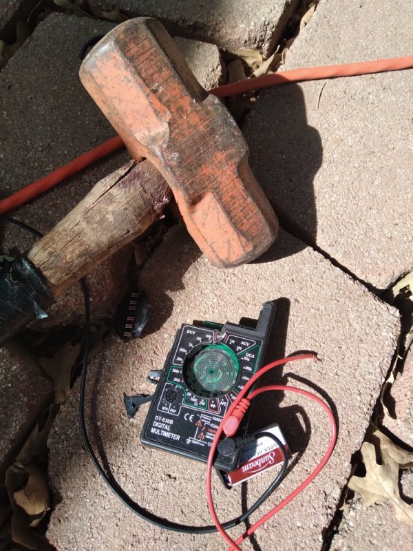

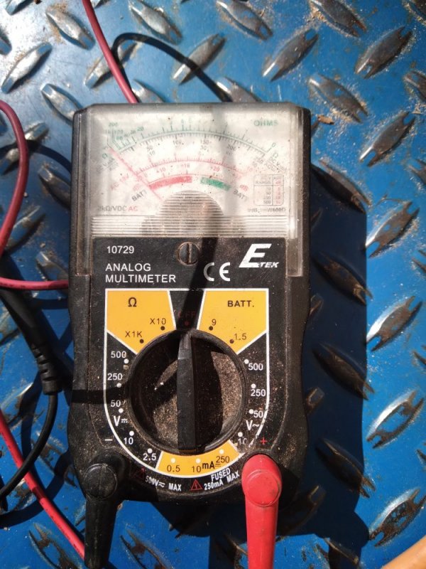

Once all that is back together except the battery ground cable (always last to go back on anyways), you need a multi meter for testing amperage. I hate the harbor freight $5 meter- but if your broke it is ok for this use- NEVER use it on house power even though it says it is rated for it- they are not trustworthy and can kill you. Hopefully you already own a good meter. Search YouTube or bitchute for “parasitic draw test”. Watch a few different ones because some people miss a step- like open doors etc. I can explain steps of testing but watching a video is probably better.
