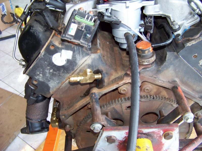

If I end up putting a turbo on this.... where is a source for the oil supply for the turbo?
I get a "T" and tap into the OPS location on the block. Be careful of firewall clearance with some "T" improvised designs as the "bad example" I show below was hitting the firewall. Some can get the plug by the oil filter out and use that location. The 6.5 location is in front of the block.
