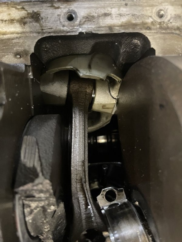

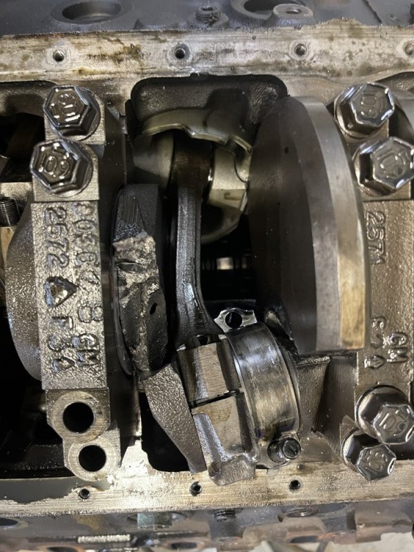

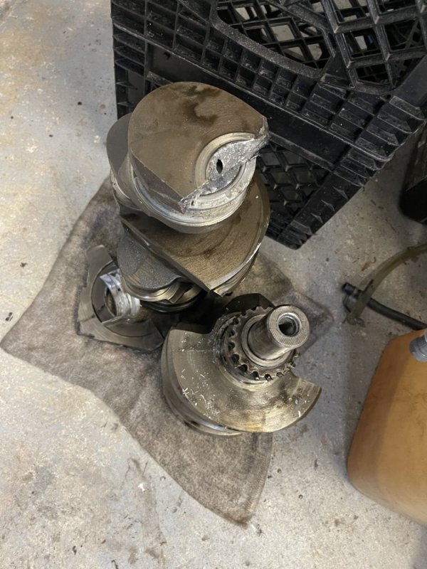

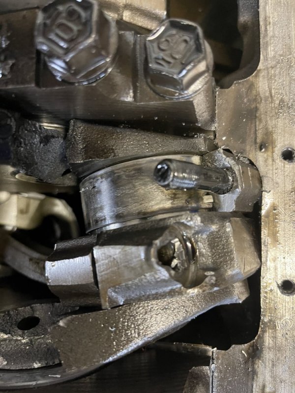

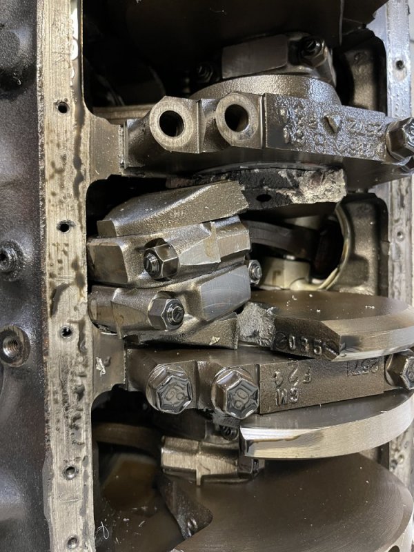

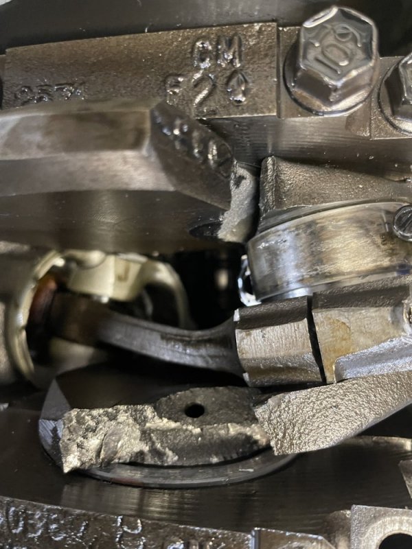

Well, it doesn't look like I'll be rebuilding the 599 block I have

So I have 2 929 blocks and a 506 block that was a warranty block in my Suburban before the P400. One of the 929 blocks is Ferminators old 6.5, the other came from a 95 K2500 Florida Forestry truck, which has a cylinder pitted from a blown head gasket. So my next move is to disassemble my 506 block and check it out, I know the history and I ran Amsoil in it so we'll see what it looks like when I get it tore apart.
