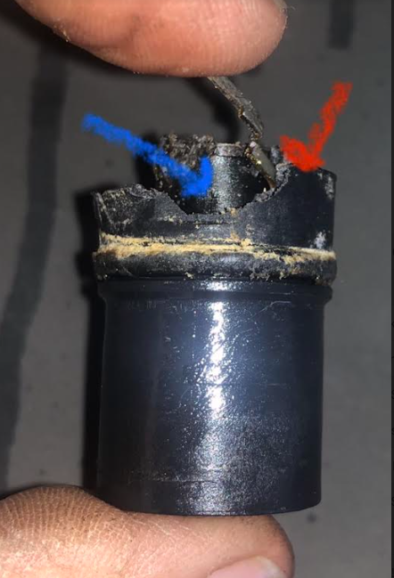

So I found something that needs to be fixed. Or I should say I made something to be fixed.
The Plan was to remove the VSS's and swap them front to back. Easy Peasy
Things that have been together for 30 years tend to stay together. I think that is one of the laws of physics...
So the front one was being an SOB, so I removed the rear one. Felt the oring compress and it slipped out.
The front, not. It spins in the hole, but I can't get it to budge outward. So I pry a bit. Spin and pry. Pry and spin and snap...
It snapped off flush with the case, the metal retainer came with the plug.
Debating a small chisel to break out the sensor back to the oring area. Then it should slip out.
Or, drill into the sensor, into the steel core, thread it and use a puller of some sort. (maybe too tight of the space for that)
Considering cutting into the good rear one to see what is inside the sensor for clues and ideas.

I won the stuck VSS battle.
I'll post this here as part of my issues, but it may be useful to others for a regular VSS replacement gone wrong.
The drill and tap, no go. No room for the drill.
Used a freshly sharpened small 3/8" wood chisel.
Using a small hammer, cut into the plastic, the steel core is right under the plastic.
Cut away until a good section of the core was exposed. (see below)
I was able to get a corner bite on the core with the vicegrips (man what a tool!!).
Pulled, grunted, pried, and pulled. Pop. It came out.
The sensor broke flush with transmission case. Red arrow.
I cut away with the chisel to expose the core, blue arrow.
The dip from red to blue is the portion chiseled out.
Got to go get a new VSS.
