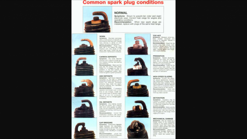

Throw a timing light on it. Compare spark rate between all cylinders. Have you pulled the plugs to see how they are all burning? My favorite chart from hose days:
