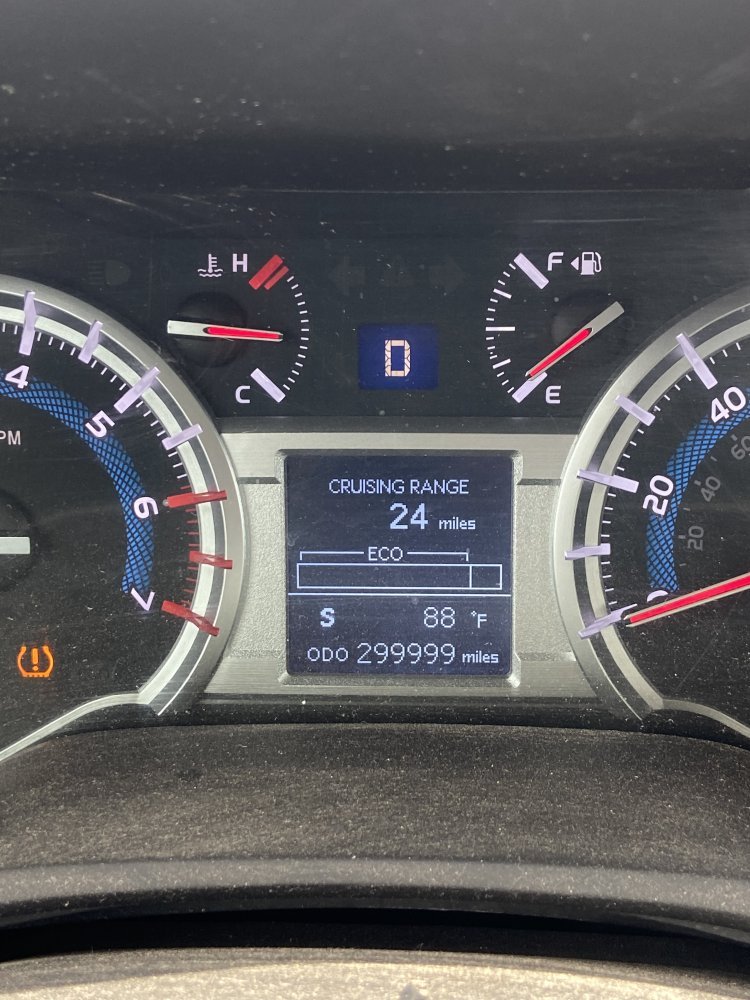

Truck just rolled over 300K miles and all suspension is OEM.
