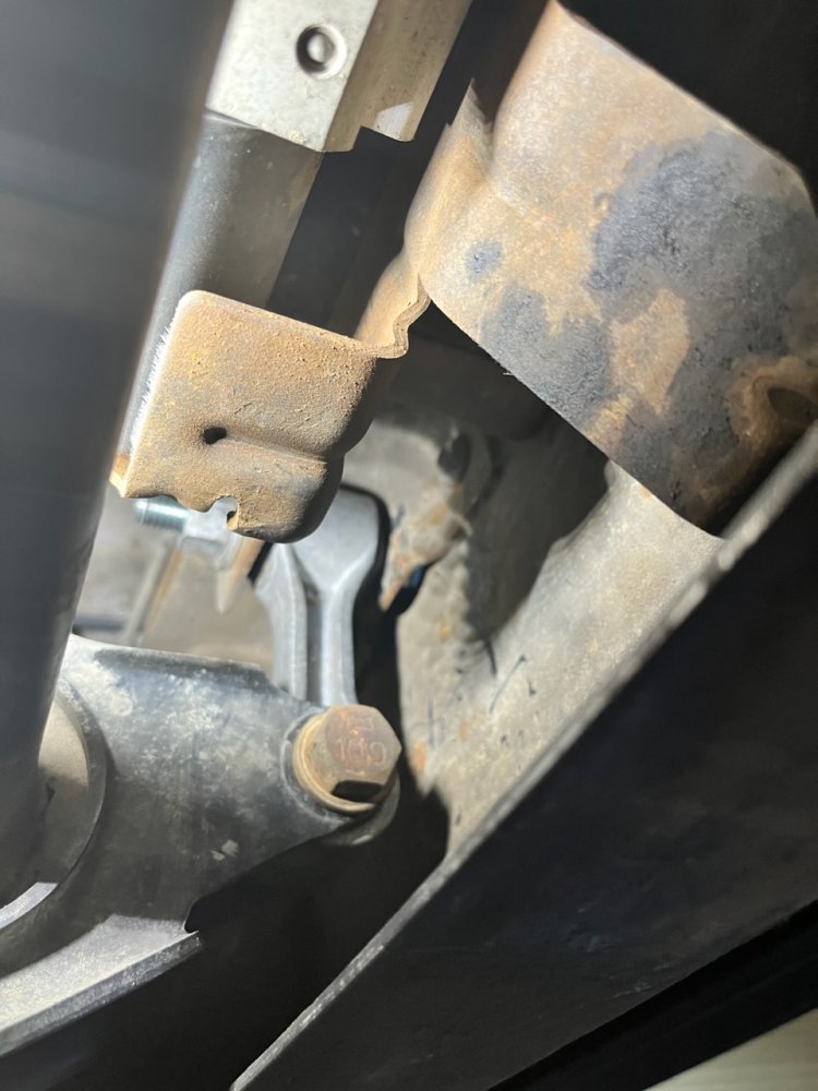

So I’ve had this arb compressor kicking around the garage for a while. Was really running out of options to Mount this thing. While I was changing out the torsion bar cross member link/bushings I noticed under the driver floorboard it appears to be an aluminum heat shield from the driver side cat used on the old 8.1. Its above where the fuel cooler is currently mounted so i pulled the fuel cooler off and removed the heat shield. It’s nearly the perfect size to mount the compressor to. Since it’s aluminum, it’s a bit thin to support the weight of the compressor so i ended up using it as my template and traced to some 5/16 steel plate. Cut it out, drilled the holes , painted it and it fits like a glove. I’ll work on plumbing the air lines another time but for now it’s mounted and wired up so i can use it if needed.
There’s actually plenty of room for the fuel lines and there’s no sign of rubbing but this picture kinda makes it look closer than it is.
