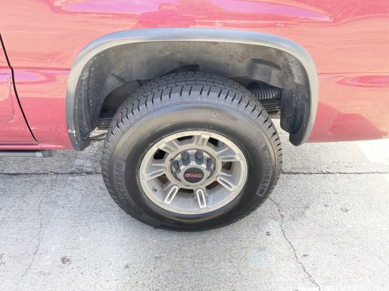

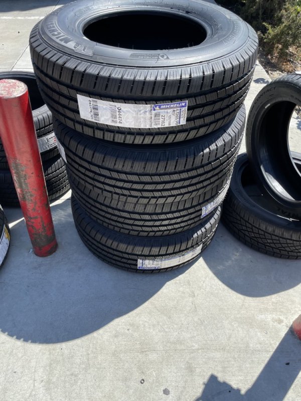

Yeah that’s what I gathered after reading some threads but they seem to be a few years old. Hopefully things are improving. I have read that PSC seems to be a little better but almost twice the $$. I’m willing to pay whatever to make it right as it’s really annoying having to keep over correcting to keep the rig straight with the trailer. I did get some Michelin Defender LTX M/S in LT265/70R17E mounted today on the h2 wheels. We leave Friday for glacier so we’ll see how different it behaves with these tires over the continental’s.

Nice choice on moving over to H/T tires. That should get an instant 10% improvement in fuel economy and firm-up the ride a bit as well.
About the sway, I never met a 3/4 ton Burb that did it and they were very stable with a 8K# trailer. So that steering box is likely the issue. While not missing my old 3/4 ton Burb's habit of unscheduled shop visits, I do miss its rock solid towing manners.
I'm really liking the Michelin's. I've only got ~150 miles on them -- I'll have more on them next week with the trailer.

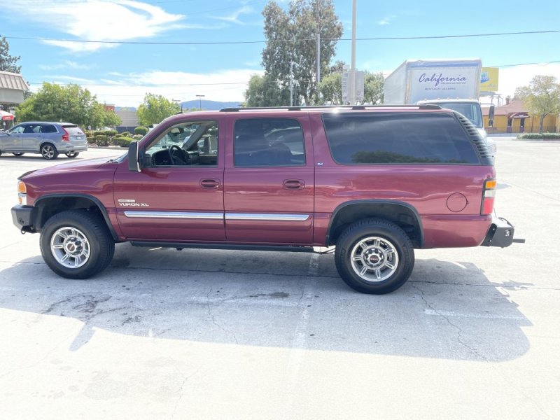

How’s that conversion working out with California smog laws? Latest I heard is they are matching the engine to the VIN # which would create problems for a conversion.
So smog is actually due right now. I’m gonna do it tomorrow. Last two times was no issue with the state smog ref. It has a BAR label on the firewall. So they just smog it as if it was a 2006 Chevy Silverado 3500 with an LBZ based on the engine family. DMV has the vehicle marked as fuel type Diesel and there’s something in the computer that directs them to check for the BAR label. I’ll update after tomorrow’s smog test.

Cali used to have all those same requirements and would allow diesel swaps so long as the diesel was emissions certified for a like vehicle(the engine from a 2500 pickup to 2500 Suburban was acceptable, but say the engine from a 2500 pickup to an S10 would not fly as they were in different emissions categories). I haven't heard from anybody in a Cali who has smogged a diesel swap since the new July 13, 2021 rules went into effect. I know I talked to Rick Fletes and he said he had to stop doing LLY/LBZ swaps to 02 and older Subs because they required a tune segment swap to make the fuel guage work, and Cali would no longer allow anything but a 100% stock GM calibration(even though he was using stock GM tunes, just mix and matching them to make everything work). I know several are saying even LS swaps are getting difficult to do and make emissions legal in Cali in OBS trucks.
I’m actually at the smog shop right now. So I’ll have results shortly. But as Ferm mentioned, I actually had this problem back in 2017 when I got it ref’d for the bar label. I had a stock tune with the modified dual tank stock gm segment and hey wouldn’t accept it. They called it a part number that was not issued from gm for the donor vehicle vin. So I flashed the original tune from the donor with all original segments and it passed with flying colors except the fuel gauge didn’t work. After smog was done, flashed it back with dual tank fuel segment and all is happy. We’ll see what happens here shortly.
So I do have the factory tune loaded from the donor truck so the fuel gauge doesn’t work. But it makes the smog machine happy. Other than that I still have the cat and egr intact. So it passes visual as well. The smog tech knew it wasn’t stock when I pulled in. He just wanted to know if it had a BAR sticker. It does, so he was happy to do it.
