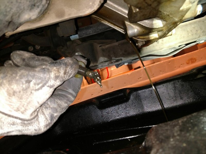

Was going to change the oil as it has a minor driver side seal leak and is slightly low on oil. Easy-peazy and go on to next project right? 119K and PO changed the oil at least once sometime in the past.
But, why bother changing the oil when you can have the diff rebuilt, cleaned out, and resealed? o_O
I mean nothing like stopping an oil change because you can't read the ground up part numbers coming out in the oil! :facepalm: Not only was the magnet full there was a clogged toilet glop of metal that also came out at first. :wtf:
Stick a fork in it done. :dead:
Looks like vent disc may have been loose as it just popped off when we went to pull the hose off. Driver side axle shaft has lots of play and a ugly thunk-thunk when you rock the pinion back and forth.

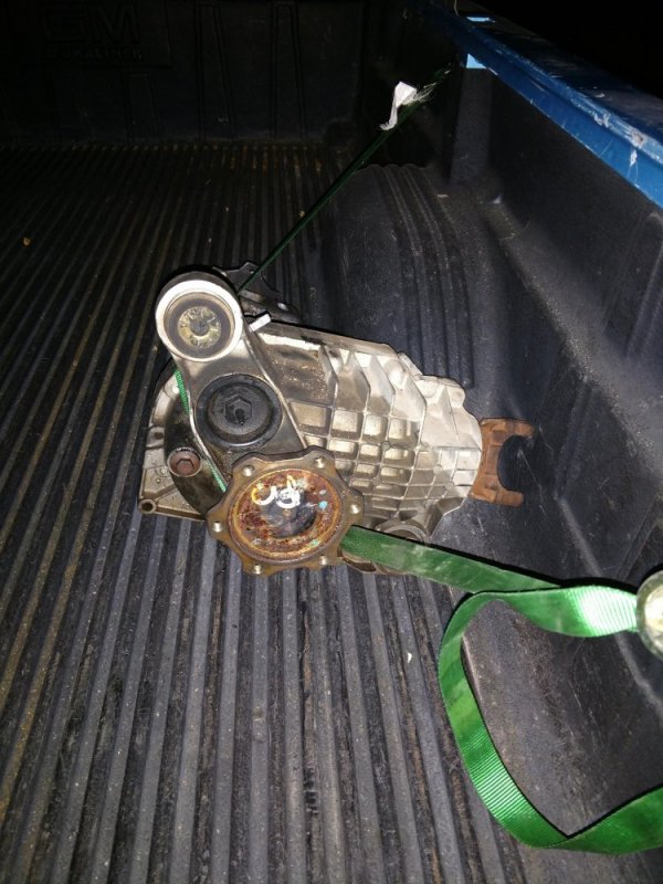

Although thetruckmodcentral has a nice how to guide on removal the poster is dyslectic: you turn the wheels to the LEFT (make left turn) to get it out. At least for 2002.
Going to replace the steering box pitman arm as it's sloppy. That's the other removal option is to get the steering bar out of the way.

Yes rebuild cost more than a JY unit at over $850. In a hurry to get it fixed first of all so having the right one and proper ratio to go back in the 1st try... (Full time vs. auto part time vs. manual may have different parts.) Second GM changed something in 2003 to address failures. Bad OEM bearings, wrong preload, locktabs sheering off - whatever. (Don't want to do the job a second time if GM's issue pops up in the JY unit.) Third is a longer warranty.
If the spare one from the 1993 would have bolted in...
And doing the front end, tie rods, idler, pitman. Couple grand for the "oil change". Wasn't looking to do this much, but, I did bring it over for some TLC.
So it needed bearing kit plus Ring and Pinion.

No, had a local diff shop rebuild mine. Aka rent good experience. Remans actually cost more, ~$1100, even on Rock Auto.
