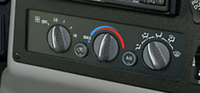

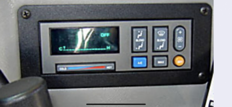

the hvac systems are also like that where the years are different. They style with the square buttons in the pic are used up to 95 that I know of. The other style with 3 dials and 2 buttons is in 1997.5 and newer - idk if they ever changed after that. I dont have a pic of the 97 (and maybe 96?) where it had the dials but not the buttons.

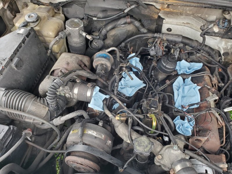

Passenger side valve cover soaked in oil
Driver's side valve cover bone dry
Dipstick shows about 2 quarts heavy on oil.
What are the chances the oil pushed past the pcv valve?
Is it possible to chance valve covers gaskets without removing the intake manifold? I'd rather see if it runs before sinking much more money into it.

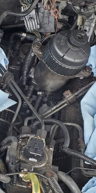

Should the fuel filter housing drain be plugged? Or... Can I use the rest of the clear tube and reroute the drain to an easier access place?
Also, when I replaced the return line off the injection pump to the fuel line the fuel was shooting out!! Haha

2 quarts overfull, that is probably why there is oil everywhere.
drain the level to proper amount. Just wash the engine and wait on the valve cover gasket.
You have to undo injector lines to remove valve cover. I say wait until it has a few miles on it because you might find more oil leaks after a bit. Could be it isn’t leaking bad, just crazy over pressurized from too much oil.
yes, cdr (pcv for this engine) is probably soaked along with your intake to the turbo.
I wouldn’t use the clear line on there too long because when the return loop leaks in 1/4”, you can easily see it by accident with the hood open.
when the drain line leaks it soaks the whole underside of the truck before you notice.
also the clear line should be 1/4” and the drain line is 5/16. Yes you NEED a drain line to a valve- thats how you get the water out if there. Locate it any where you find convenient, so long as it is below the ffm the entire way. Any uphill line can allow the water to build from that poi
