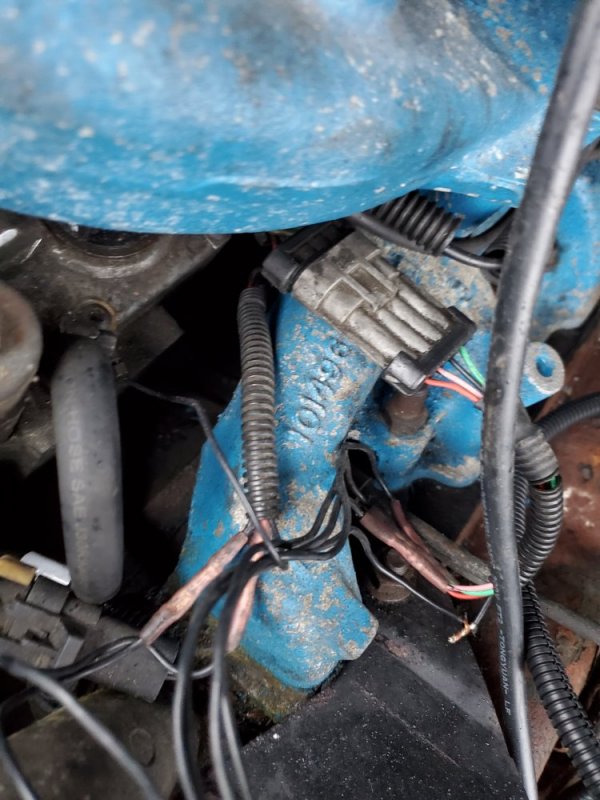

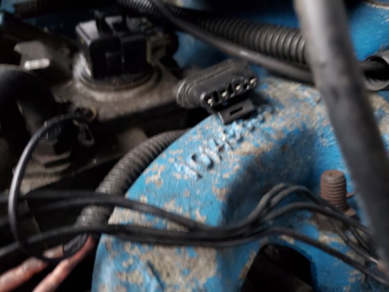

So... Is there an adapter for the PMD connector?
Plugged in a new PMD into the crappy 2 piece harness that's there and the new foot pedal, and no noticeable difference, but I didn't have a chance to work on it long.20200125_171958.jpg20200125_171936.jpg

I wonder if the $35 injection pump pmd harness would work.
A wiring harness might but a great idea, but if I can confirm it runs first, that would be fantastic..
Yeah, it would be nice to hear it run, even if it was for only several seconds, enough so a person could determine if it sounded good enough to invest more into it.

I'll get the $35 cord - although - this is the response I got back from Quadstar:
"You(')d need both the injection pump harness and a PMD extension cable to repair that. And remove the intake to install it so intake gaskets also"
If I actually need to remove the intake, that would be a prime time to move the harness outside of that valley, wouldn't it?

If you replace the harness, the new one would be good for the next 25 years, and it all wont fit well "outside" the valley.

I think that Quadstar recommends laying their harness to the outside of the intake manifold.

It can go either way. I ran mine underneath because my braided fuel lines are in the way up top. The harness is better made than the original so will probably last longer. The guy that makes them lives in Texas and it is a real nice harness. The glow plug harness is designed to be run up top as well, at least the passenger side, and it cannot be run underneath. The number 8 wire is too short to run it that way.
