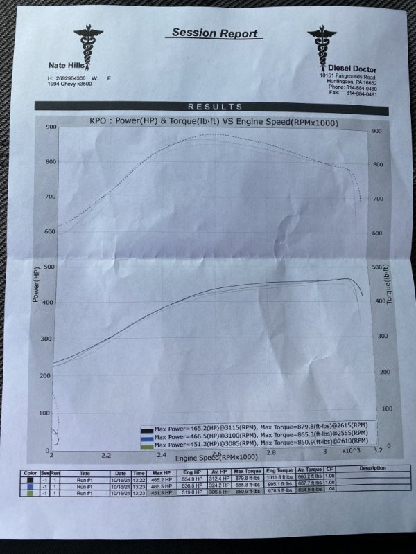

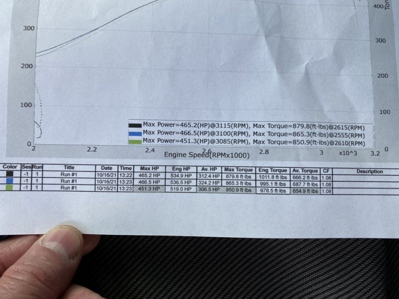

Today, @Duvall made it down and the three of us nearly pooped ourselves when The Diesel Doctor handed me the dyno sheet after he ran the truck on his dyno…..:oops:

Yeah, that was holding back some fuel for sure!
I didn’t notice the curve at first- that is a nice climb without sharp peaks.
It’s super gratifying to see the work I put into the fuel delivery system pay off in the end. Now rather than drop to 16psi, my inlet fuel pressure stays at a rock-solid 25psi…..with the same Raptor 100 lift pump.
What a fun weekend! Always great to talk to you in person Nate. I still can't get over those dyno numbers! It was awesome to see your build up close ans watch it lay down the new DB2 (2 plunger) all fuel record 😎. Looks like the next step is 500hp!!
