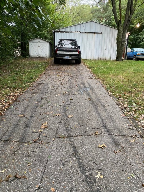

It's running pretty good though. I need to get the boost controller working so I can tune the rate at which the fuel gets delivered. I used to launch the Tahoe at about 6psi in 2wd and that was about the limit of traction. I figured I could do more with this truck since it's a dually and heavy, so I tried 10psi. It did this instead. And it would have spun them for longer, but I had to get out of it so I wouldn't hit the barn. I sure wasn't expecting this heavy truck to do that.

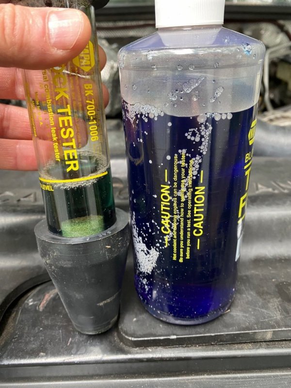

That's the good news. Now the bad news. Before I took that picture, I was driving the truck around and beating on it, trying to observe boost and smoke at rpm. I made a stop at the grocery store and when I came out there was a puddle of coolant under the truck when I came out. Hmmmmm. I popped the hood and it was coming out of the overflow. Interesting. It was in the 60s outside and the engine hadn't gotten above 175 (which in itself is interesting since I'm running the supposedly "good" Delco 195 thermostat). When I got home there was more coolant coming out of the overflow, in fact you can see it in the picture above. This doesn't feel good. Overnight, I thought about it and convinced myself I have a head gasket leaking at higher boost or a cracked head. Bollocks. I checked my coolant level the next morning and it was exactly at the Full Cold line. Ok, maybe it was just overfull? I recently had a leak at one of the rear block-off plates and I hadn't really driven it much since then, so maybe it was still just overfull. And I cranked the engine and it wasn't hydro-locked, which I was afraid it might be if the cooling system was that pressurized. Hmmm. I picked up a combustion gas tester from Napa to see if that told me anything. During that drive, I hammered on it some more. Yep, more coolant came out. I can't think of anything else that would cause coolant to be pushed out like that now that I'm running more boost than before, when I didn't have a problem at the old boost levels, but I figured I should still test it. The fluid didn't turn yellow, but it definitely wasn't blue anymore.
So the top end's coming off. I'm going to have the heads pressure-tested and if they're good, machined flat. I skipped that step last summer because at that point I was still in a rush to try to get the truck together for camping (which I ultimately never achieved anyway), so shame on me. Hopefully the machine shop can turn the heads around quickly because I'm supposed to take the truck to Dinosaur Camp at KOS October 14-16, so that doesn't give me a lot of time to get it back together and sorted out, plus we're going on a vacation for 4 days before that, so even less time. Oh well, it is what it is at this point.

For the coolant, right now I'm running almost all distilled water. I didn't want to invest in a bunch of antifreeze yet since I was still shaking the truck down this season. I do have 2 of the little bottles of dye in it right now, as well as a little residual antifreeze that was in the block before I installed it. I understand what you're getting at with the test, but there are 2 things that are making me not want to do that: 1. I'm already about an hour into tearing it down. Sure, I could put it back together and give this test a try, but that sets me back multiple hours when I'm under a time crunch (yes, this could save time if not the heads/gaskets, I know) when 2. What else could be shoving coolant out of the system when I'm pushing high boost/cylinder pressure? The tester was really just a sanity test, and it's hard to get a good sample when it's only pressurizing the system at high pressures (no bubbles at idle). You've been around these a long time, so I'll definitely listen to any of your thoughts on this.......have you ever seen coolant pushed out for a reason other than heads or gaskets (or a block, yes, but this is the same block that was in the Tahoe, so I'm leaning towards the other variables first)? If you have another idea, I'll explore that, but right now I can't think of another reason unfortunately and I feel like my best course is to get the heads to the machine shop as soon as possible in the hopes I can get the truck back together in time for the event.

Also, from my experience using the chemical combustion test fluid multiple times on the 94 Turbo Subaru with coolant passage issues, any color change - going green from blue, is a sign of combustion gases in the coolant.
