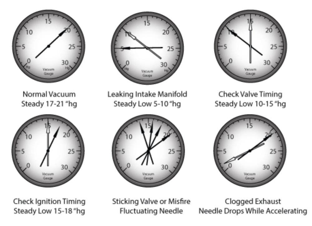

First hook up a vacuum gauge to the intake manifold.

That's a good idea I can read the MAP off the scanner for the intake vacuum.

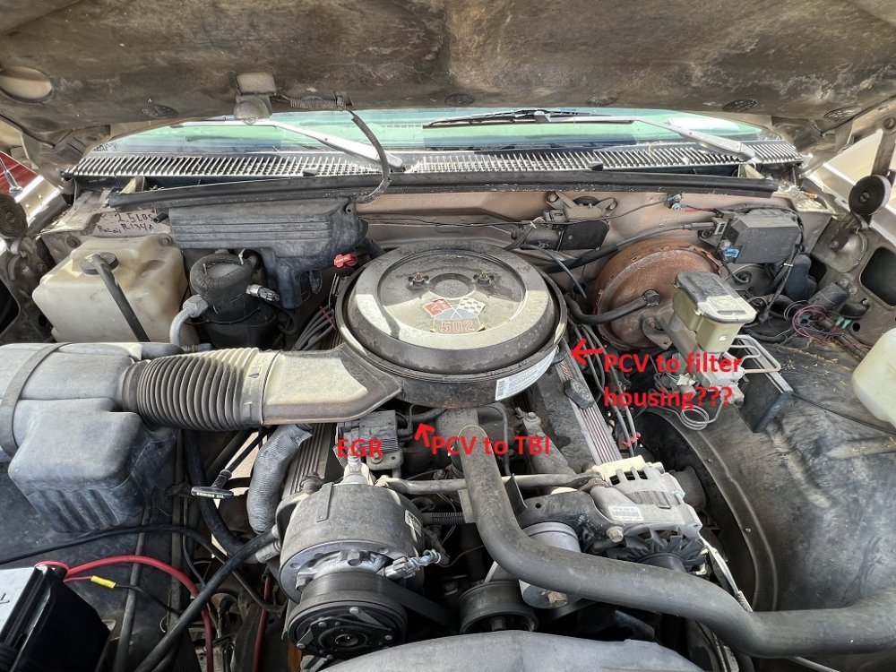

Oddly it has two PCV valves on the engine. Looks like a screw up as the "fresh air" from the air cleaner housing has one shoved on it at the driver side valve cover. IMO should only have one PCV from the passenger valve cover to the TBI unit.

No, you have to have air inlet to the crankcase somewhere. The pvc is sucking out air. This means fresh air has to come in somewhere. Usually it is through the air filter housing via a hose to the opposite valve cover. iirc inside the filter housing is a small 1” X 2” tiny filter where the hose connects. Then that hose goes to the driver side cover. Been a lot of years though.
Yes bad booster becomes a horrible vacuum leak. Hence the vacuum gauge test. Takes. Like 30 seconds and tells of any vacuum leak along with other problems.

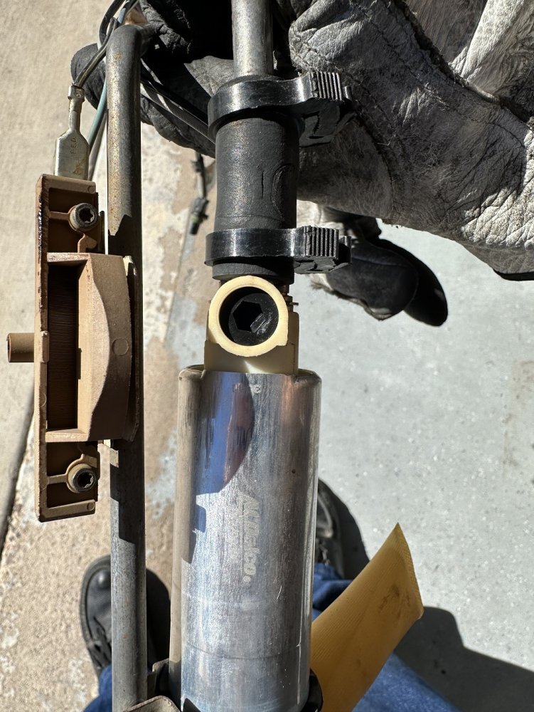

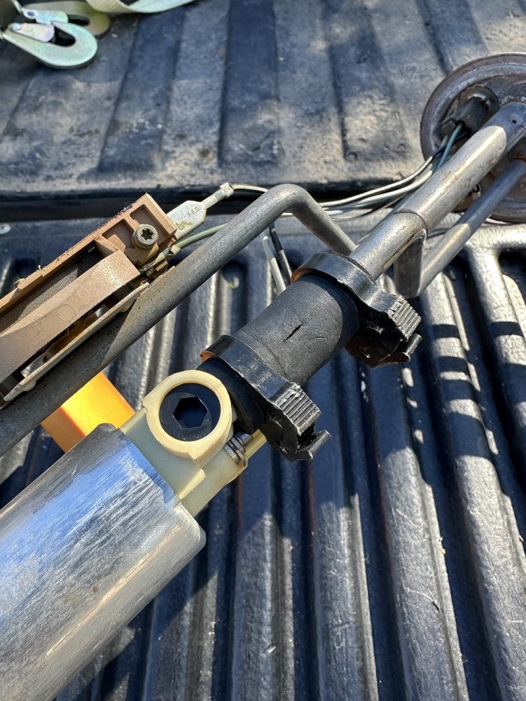

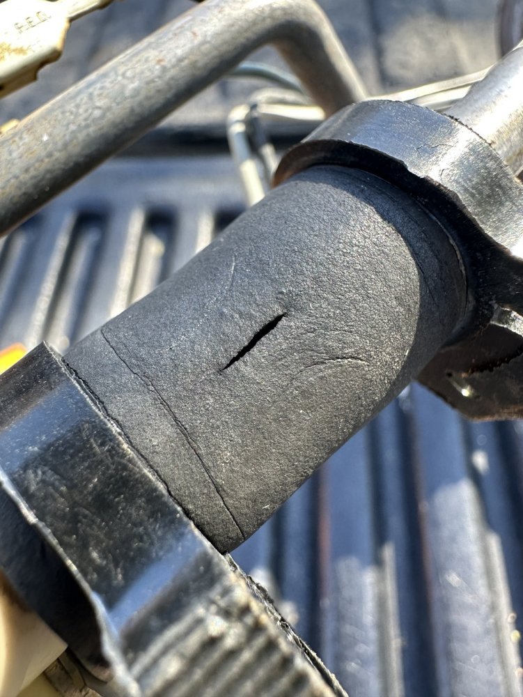

Found the problem. Cracked fuel hose on the fuel pump assembly in the tank. (Not an AC Delco Part.) Runs like it should now. Further no more idle speed hunting. We followed the advice to use a 1996 Vortec pump that isn't maxed out by the stock power level on the 1993 454.

You use those same plastic hose clamps ?
Just curious, I have reused those many times.
Brand new Dodge van, would not start. I was new to the TBI systems. Removed the air filter and cranked over the engine. I could see it was squirting fuel but was it enough.
Took a pump style squirt oil can, dumped the oil, filled it with gasoline, cranked over the engine and give the throat of the TBI a couple of squirts of fuel. Engine fired right up.
Dropped the completely full fuel tank, pulled the pump. One of them plastic type clamps had not been clamped securely over the tube area that the hose slipped over, pressure pushed the hose off and it was not delivering full pressure.
Repositioned the clamp, tightened it around the hose and all was fine for the life of that van.
It comes as an assembly with the hose. We are not replacing just the pump, but, the entire module with level sensor, sock etc. The old hose was also 'loose' so yeah don't think much of the clamps. They only got to last longer than the in-tank pump/motor lifetime warranty, err um, vehicle gets gone for some reason or warranty forgotten.
