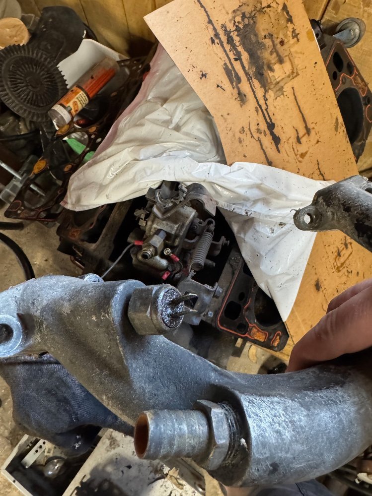

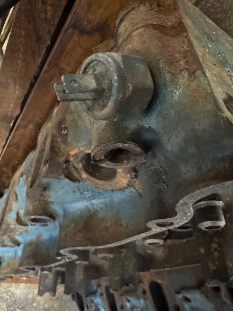

Just acquired a '93 K2500 Vin F from my father in law, had a few issues, ive resolved a few need some help on others. When I got it it wouldn't shift unless you revved it straight to the danger zone, check TPS couldn't get it set in spec, so I swapped with my old 6.2. Got it so it shifts nice through all 4 but I'm not getting T/C lockup. I'll have access to a scanner shortly, maybe brake switch? Other issue is the CTS for the cold idle/advance is stuck on, if it's plugged in it's on fast idle, unplugged it slows down. I'm not really wanting to spend $80-$120 for a new switch. Has anyone converted to a new style? All it really has to do is break contact at 100 degrees correct? Otherwise I'll just put it on a toggle like my '91 was. Thanks in advance

New brake switch fixed the issue, trans shifts perfect. Still hoping someone has a alternative sensor I can make work for the high idle/cold advance. Toggle switch works fine for my but when other people drive it they get confused. Might have to spend the $80
