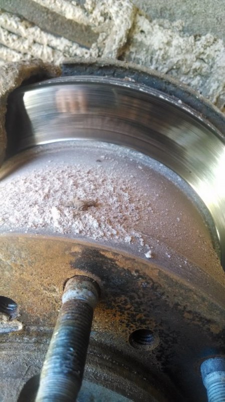

Pass side is worn on the rotor but there is still material left on the pads, not much though definitely touching the squeaker

Ended up ordering new ac delco, remans were all labeled srw. Also 2 of the long life rotors as the slotted ones werent Raybestos.
Also ordered a full set of new slide pens.
All I've ever gotten with pads is the metal shims, and the Wagner ThermoQuiets I got from O'Reilly's a few weeks ago were even missing those. Everything went together fine and the pins and boots were in awesome shape (thank god for California trucks).
3 of my front pins were fine, one had light scoring. I'm assuming the rears might be ugly. My front boots and pass side rear boots look fine. The driver side rear is screwed 10x over
