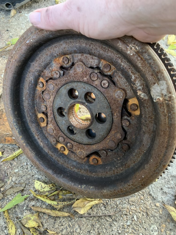

Just thought I'd update the thread. the poor Jetta is down for the count after having to tow it back home from the next town! got it home and up on stands thinking that it had broken a cv shaft. Nope! something in the trans has broken, cranking it up grinds like hell but the wheels both turn and will shift gears but sounds horrible. I think it's ether gonna need a new dual mass flywheel or a transmission! :(

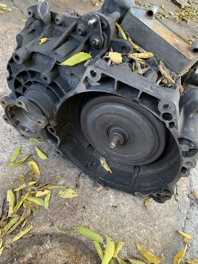

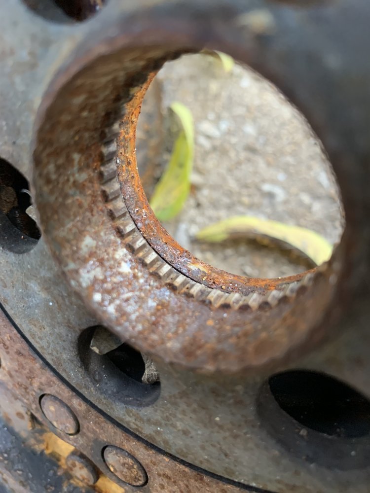

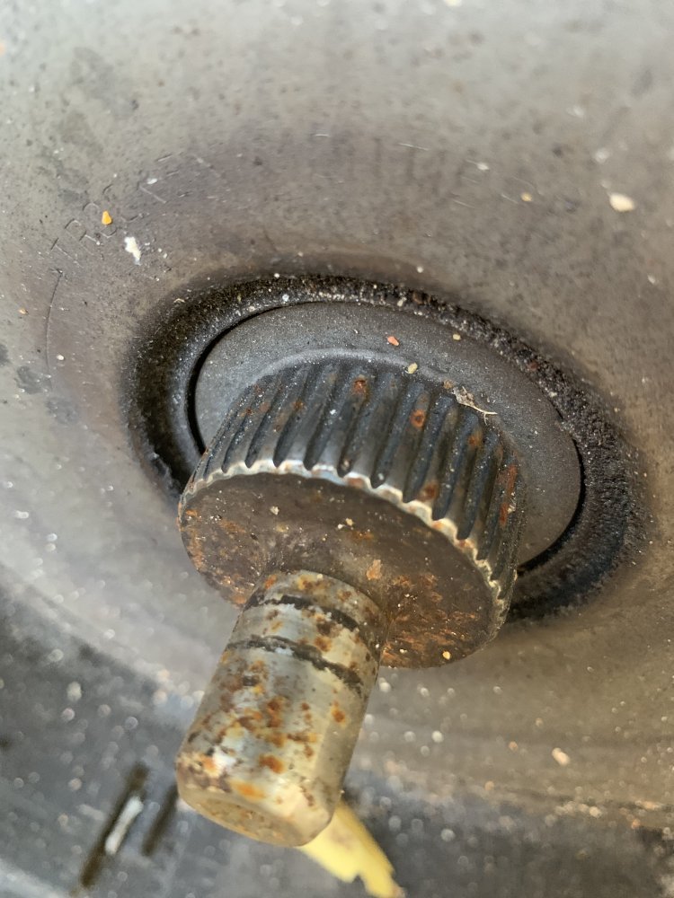

I never got around to posting an update on the status of the Jetta. Well, rewind back to October I finally got the courage to pull the transmission to find out what happened. Why the grinding noise and not moving under its own power. Checking the CV axles along the way. When I had pulled the tranny I found the dual mass flywheel had no splines left and the trans input shaft was worn pretty bad that I can tell.
The input shaft is fairly easy to remove if I can find a junk donor since there’s nothing wrong with it otherwise. Before I dropped the tranny. I put the car up on stands and fired it up. Other than the hellacious noise it spun both front tires and shifted into all gears with no problems.
Here’s some pics of the carnage…. mind you these pics are from today with a little rust setting in. it all was shiny and with metal powder all over the place at the time of disassembly
And as mentioned on the other thread, the best "fix" recommended by all the VW diesel experts is to abandon the automatic and go to an aftermarket HD flywheel and clutch assembly in front of the manual transmission. While the dual clutch "autostick" works behind the VW gassers, it's no match for the TDI's bottom end torque, as you found out when you tore that apart that unit. Oh, and if you're going to contemplate a new dual clutch and a new to it input shaft, you better be figuring in about another $3K to rebuild and upgrade that transaxle, too. Otherwise you'll be pulling it back out in another few thousand miles to rebuild it anyway.
