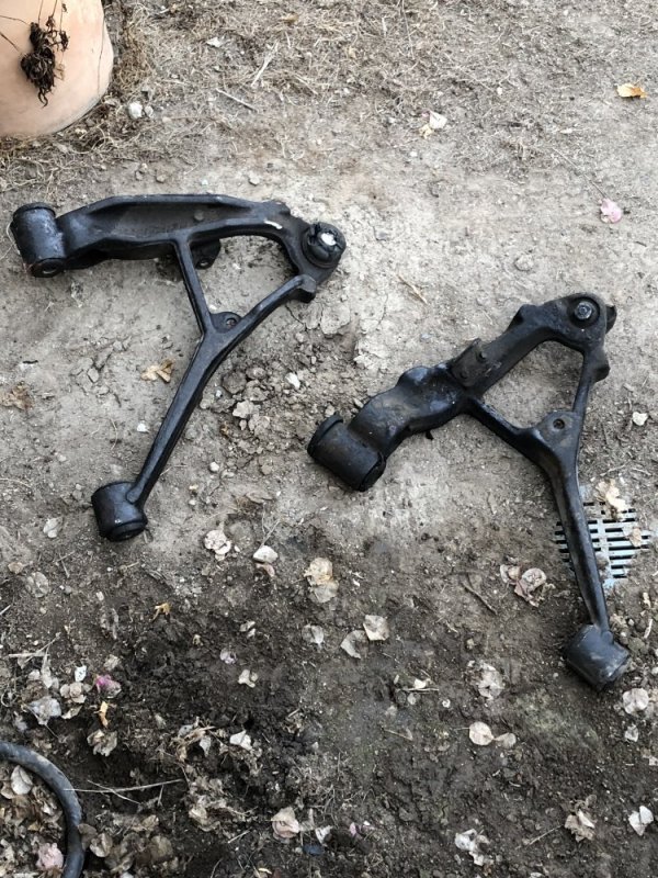

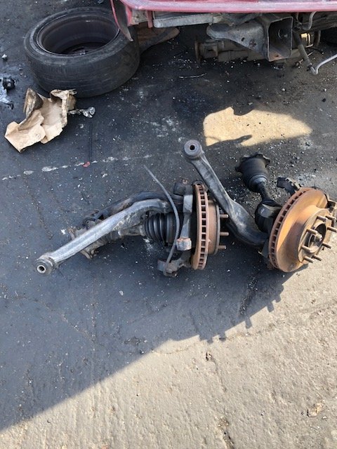

With the cast removed, I went back to the Pic a part boneyard and found the forged LCAs. They were already removed from the truck, but the entire axle/knuckle/brake assembly is still with them. I went home to get a breaker bar, 36mm nut, and a 5' jack handle to slip over the breaker bar in the hopes that I can get the axle nuts off. Is there an alternative such as removing the 4 bearing bolts? I already have the ball joint separated, but the LCA hits the CV joint.
Took some effort but got the LCAs separated. I finally resorted to a grinder with a cutting wheel to cut through the ball joints.
