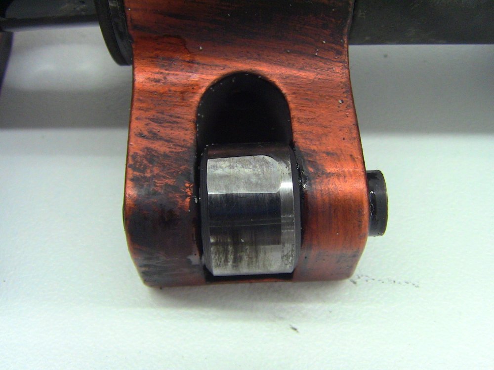

Another bad spot was the HS rockers, about 3/4 of them were flat spotted where they sit on the valves and were no longer moving on the shaft... they also had a heavy film of soot covering them, so sooty air was inside the motor because oil does not flow around the outside of the rockers... The problem with the rockers worries me, I have mot seen a set go bad like this before..
