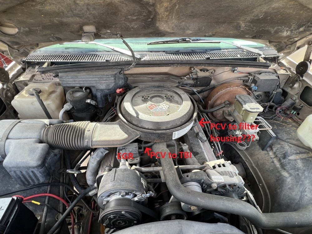

Oddly it has two PCV valves on the engine. Looks like a screw up as the "fresh air" from the air cleaner housing has one shoved on it at the driver side valve cover. IMO should only have one PCV from the passenger valve cover to the TBI unit.

No, you have to have air inlet to the crankcase somewhere. The pvc is sucking out air. This means fresh air has to come in somewhere. Usually it is through the air filter housing via a hose to the opposite valve cover. iirc inside the filter housing is a small 1” X 2” tiny filter where the hose connects. Then that hose goes to the driver side cover. Been a lot of years though.

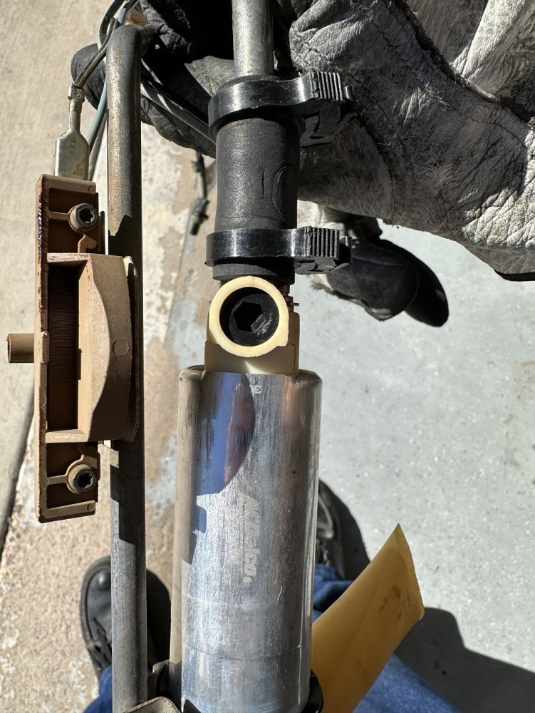

Found the problem. Cracked fuel hose on the fuel pump assembly in the tank. (Not an AC Delco Part.) Runs like it should now. Further no more idle speed hunting. We followed the advice to use a 1996 Vortec pump that isn't maxed out by the stock power level on the 1993 454.

You use those same plastic hose clamps ?
Just curious, I have reused those many times.

It comes as an assembly with the hose. We are not replacing just the pump, but, the entire module with level sensor, sock etc. The old hose was also 'loose' so yeah don't think much of the clamps. They only got to last longer than the in-tank pump/motor lifetime warranty, err um, vehicle gets gone for some reason or warranty forgotten.
