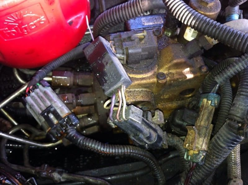

removed the intake and saw this:

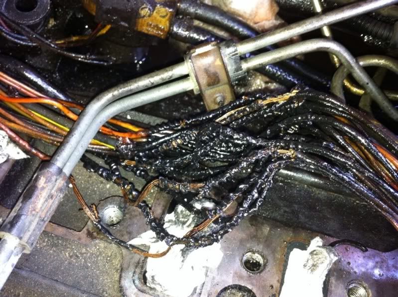

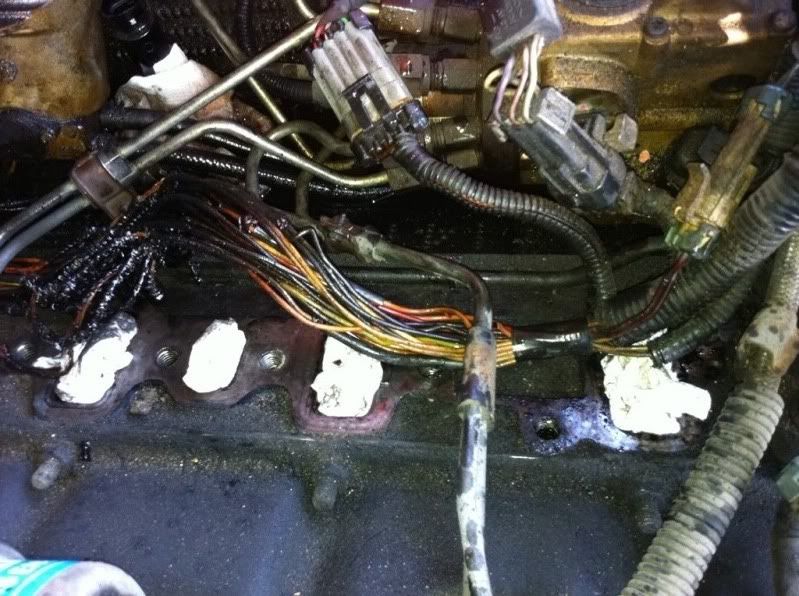

they were in the loom that runs through the valley. this was after the loom was removed.

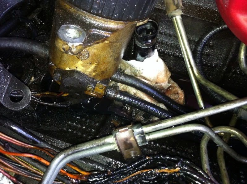

can make out the fuel in the valley:
soaking it up with towels. all lines will be replaced, IP screen will be cleaned and guess i'll get to the wires. why would they short out?? getting bathed in fuel?

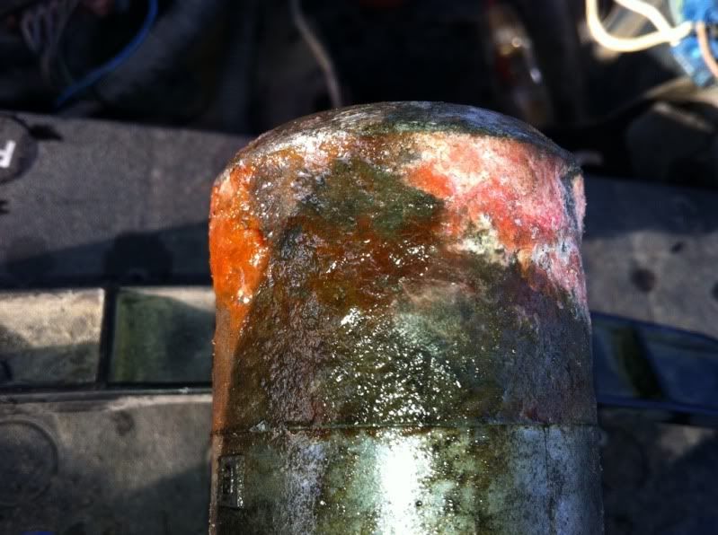

Thanx DexCool for the lovely corrosion:
A wire must have shorted and caused a small fire. I don't know if the diesel would harden the wires but they look brittle.

Definitely NOT normal if that was a serious question... I would get a different harness and replace it. And I would do a thorough cooling system flush and replace with green coolant and purified water.
yes, it was serious. will flush/refill with green.

don't think rodents did this, was way too fuel soaked to allow them any kind of home. it was also still in the loom.
i will know tomorrow if the wires are hardened from the fuel. i am going to splice, crimp, shrink tube them back. then i will run them outside the intake, not under it.
i think i am VERY lucky it burned itself out. my extinguisher is out and don"t have a spare. it was a large carbon dioxide type.
