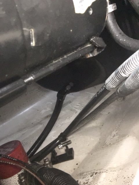

Working on my boat this evening I dropped a SS bolt that went under the i/o engine. So couldn’t get it with magnet pickup tool uhhhggg. It’s tight and can’t really see under engine or get under there. So I had the wife help me. She came down with her phone and I I called her phone on FaceTime and used my phone for a camera then hers as a view scope. The bolt was behind some hoses and couldn’t get it directly with my finger tool but was able to sweep it to where I could get to it.
This is the bolt. The red cap thingy is the bilge pump. It was just out of reach trying to feel for it. I took a few pictures to find it as you can imagine a couple of pics were blurry and did not reveal anything but they are digital so just erase them. Then thought I need real-time and said let me facetime wife's phone.
It worked pretty well just had to get some extra light under there to see the phone video. The picture took with flash. Flashlight wouldn't work concurrently with facetime. Also, found the terminal guard for the relay.
It was a pain to retrieve. Couldn't come in from this side with finger tool but had best camera view. Was able to sweep it to a more accessible location for retrieval.

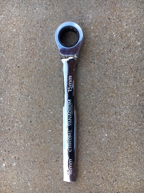

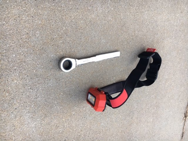

Working on IP timing the bolts are tight to get to. I cut the open end off a ratcheting wrench. I ground some off the sides too. I could thin it up some more. As is I still only could get a small ratchet turn maybe 2 teeth on the wrench due to gear lash and the number of teeth in the ratchet.

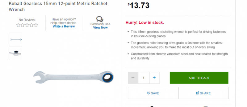

I see a gearless ratchet wrench but it is a special order. That might be a nice tool to have. If I won the lottery I think I would buy about any and every tool plus extras to modify as needed (and wouldn't buy lesser grades to cut and modify).
It's shadowy dark in the valley of the engine trying to see and access the IP nuts. I struggled with a corded shop light through one adjustment. Even with a bright shop light, you have to position it just so to see the nuts. Next I used a headlamp for hands-free light and it worked a lot better to see the IP nuts. I prefer the headlamps that can swivel down. This milwaulkie one was comfortable.wren-headlamp.JPGkobalt-gearless.PNGcutoffwrench.JPG

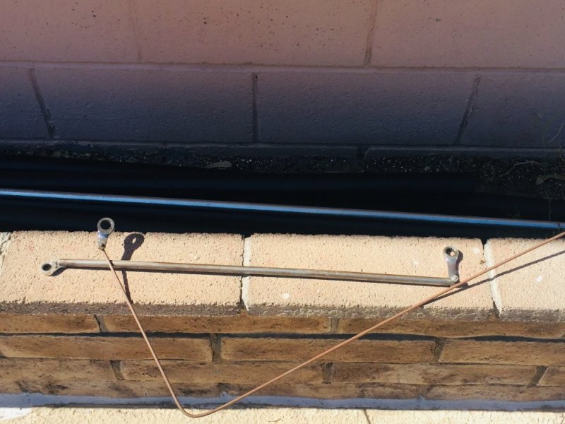

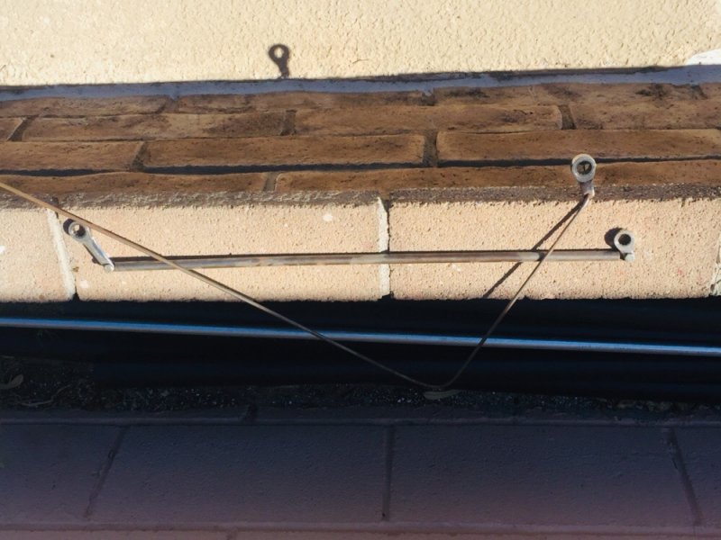

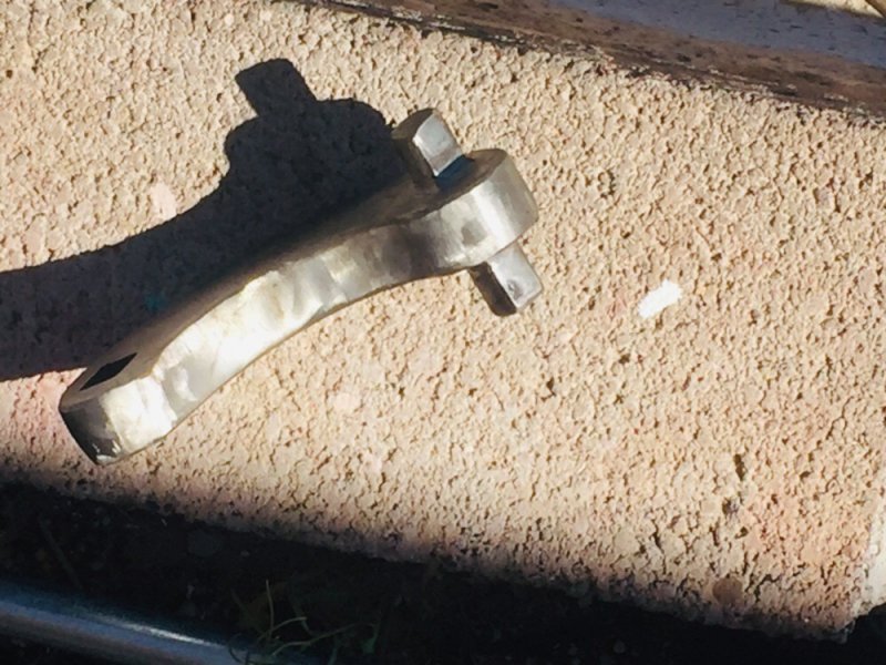

Did similar for ip, but gave that size away to friend that moved to middle of no where, gotta make another one. Thats the stubby one with metal rod. Note the wrench can swivel on the rod too. Try the brand “GearWrench”. Low price and amazing quality. Hands down first wrenches anyone should buy.

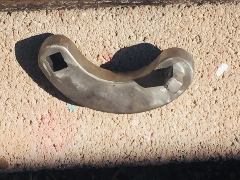

The moon shaped thing is like an extension for around obsticles.

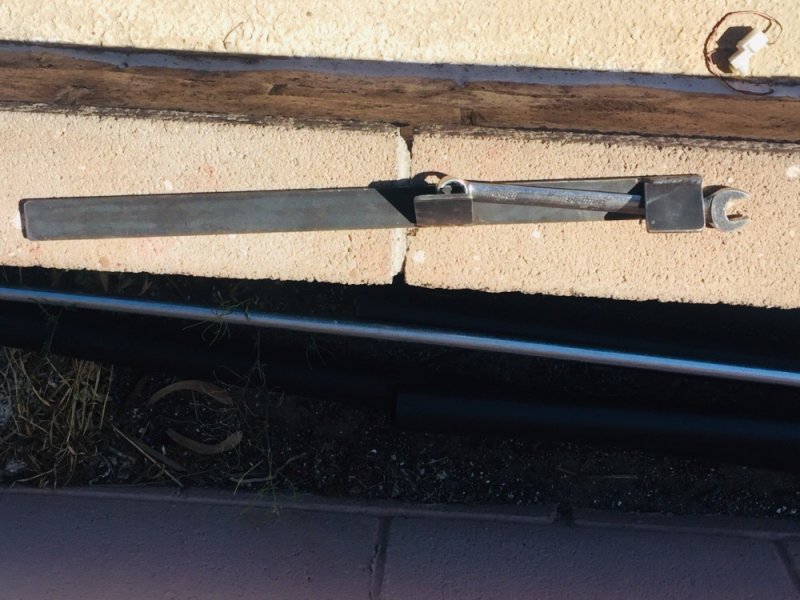

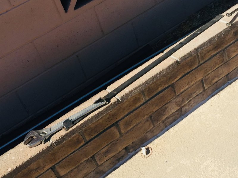

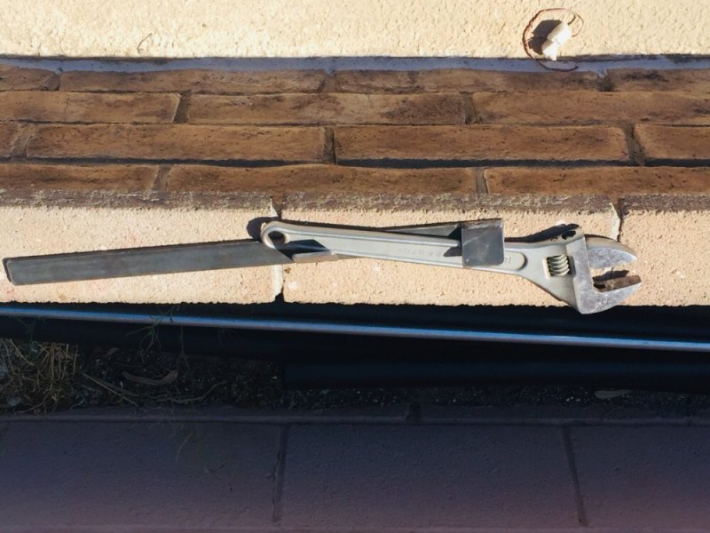

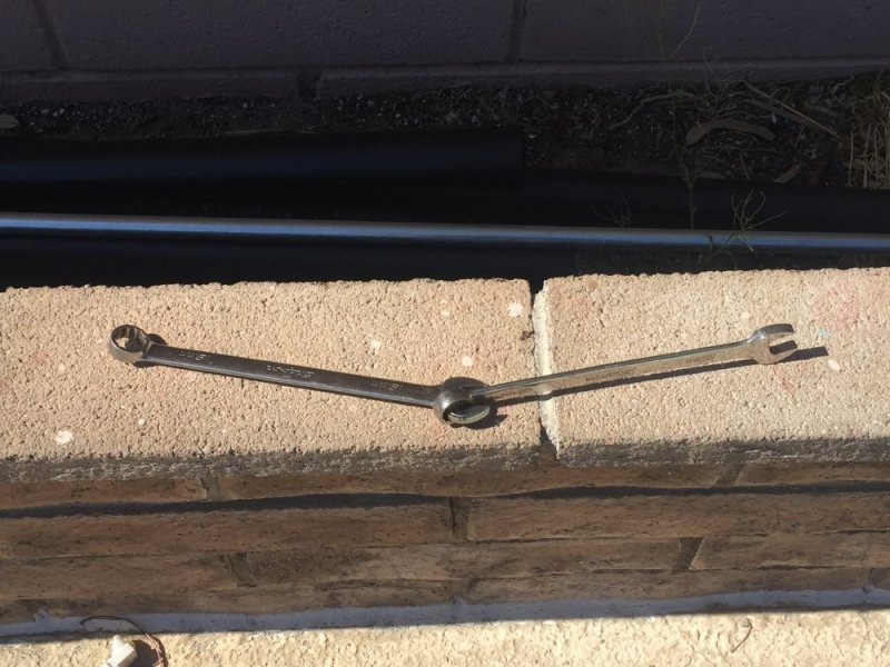

The flatbar replaces a pipe on ratchet or wrench and wont mar the tools ruining warranty. These are 2” wide for huge tools, make it out of 1” for normal stuff. Quick wrap of tape holds it in place in any position. Beter than the way to hook 2 wrenches together for more leverage. This works but can ruin a wrench.

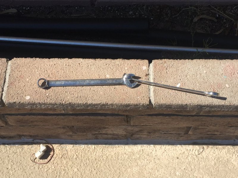

I have done the box end of wrench on the open end of a wrench for added length. Works good for just tad more umpf but has dug into a few wrenches.
I like the flat bar cheater. I try to always have tape and several small superglue packages available for when you can't hold something in place to start a nut etc. just dab a bit of glue to hold it then once started I have locked on vice grips to the nut if has something to bump. Sometimes might have to clamp something or use a block to make a bump for the vice grips.

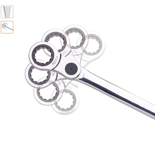

Instead of the gearless ratchet wrench the indexable wrench from Gearwrench might be better ???? First time I saw them years ago in a Sears I was dang if the wrench could get on them why would you need to index them. But yeah I can see the need. Things are getting harder and harder to work on.

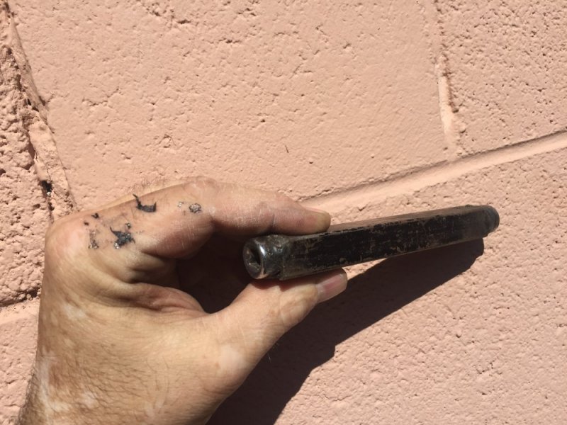

oh yeah, the last pic is the ol' Chop a socket in half and lengthen it by welding in a pipe of whatever you have around. I made that one with a chunk of broken fencing back in 85 and it is still around in my box.

the flatbar thing also keeps the moon shaped cut out of ratchet handles. I've broken craftsman and snapon wrenches doing the wrench on wrench trick.

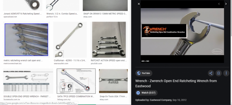

When I was in USAF, the aircraft mechanics had these (not exactly ratchet) wrenches they called 'G E' wrenches. Had the ridges to fit on bolt/nut heads, only a 3rd or ¼ the way around, & 'wobbled' on the handle, when tightening or loosening, a lil tang pushed the nut/bolt head into the ridges, gripping them. They were sooo slick & tight in really tight spots. Make sense?? Drawing a pic would be better explaination. I have never seen one since in 50 years.
-c-
I have seen similar speed or ratcheting open end wrenches. I have never used any but have been curious about them.

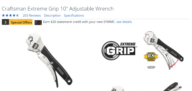

I'll give a plug for the adjustable wrenches with the tightening or locking adjustment mechanism. I received some for an xmas gift and have found them useful. They get a good tight grip on nuts sorta similar to "vice grips" or locking pliers without the sharp jaws.
I'd rather use a sized wrench than adjustable and have used the saying "The guy that invented the adjustable wrench sold nuts and bolts for a living..... You know he created and sold the adjustable wrench to round off bolts to drum up more business." But these adjustable wrenches are tighter than an open end wrench.

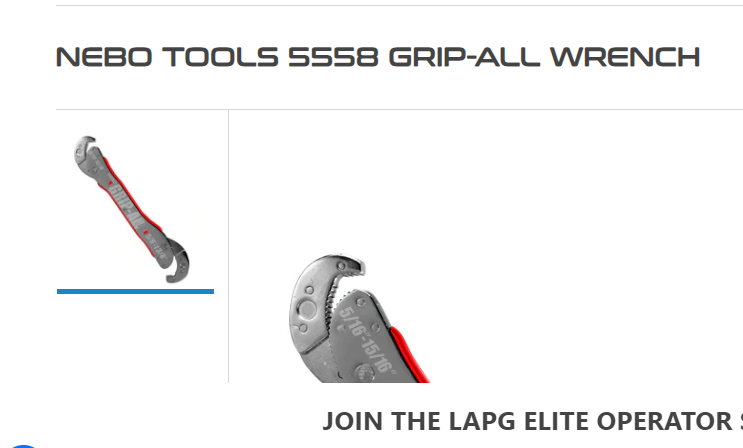

Or you could be referring to a gripping wrench like this. I have seen them in open end and a boxed end style.
Both the ratcheing and these type I sorta felt like they had better be high quality steel - same with adjustable wrenches needed to be good quality or they could easily round off stuff.
