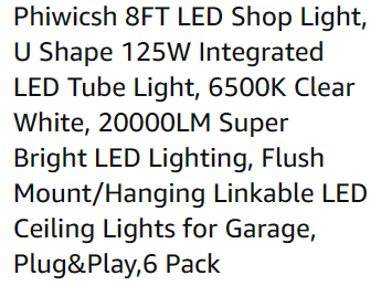

I think this may be the best choice I have found...
another couple -
The Kelvin rating can be looked at as the "feel" of the light. 2700-3000 K are more like incandescent lights such as your standard screw-in type lamp bulb. They have a "warm light" feel. 5000 K are going to be more like daylight - they're a whiter light "cooler feel" and are pretty desirable for shop environments.
Pay attention to lumens and wattage to get the best bang for your buck.
More lumens per watts with these that you listed:
However, they're both really bright (6500 K) and you will want to weigh out if you want more of them (larger quantity in the package) at the lower wattage so you have more light sources in the same area which will equate to fewer areas affected by shadows.
Regardless of which you go with, you're going to think you have the sun inside your shop as bright as it will be compared to the older fluorescent bulbs you've gotten used to.
