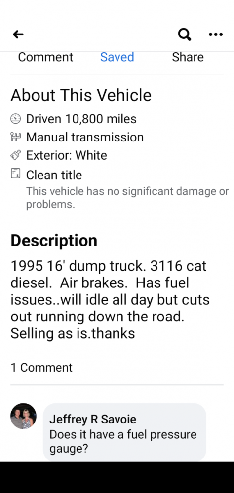

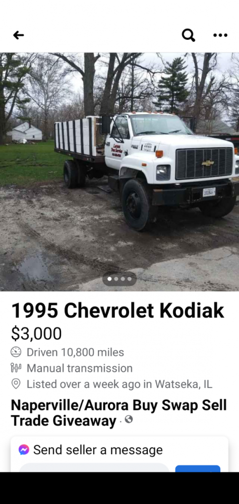

A friend has this for sale.
I'd like to have it, but I know I won't get to it.
If anybody is interested in shooting me a price on getting it going, I'm wide open to prices.
I don't think it's a bad deal as it sits.

Actually, it looks like a good deal if you know MD Diesels. If I was in the market for something like it I'd probably take the chance at $2500 after I had a knowledgeable diesel mechanic take a look at the engine.

Thanks. I'll just stay away from it. I don't have much luck hiring anyone to do anything.
