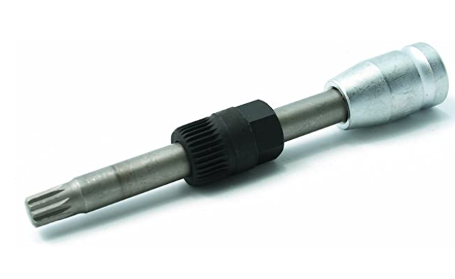

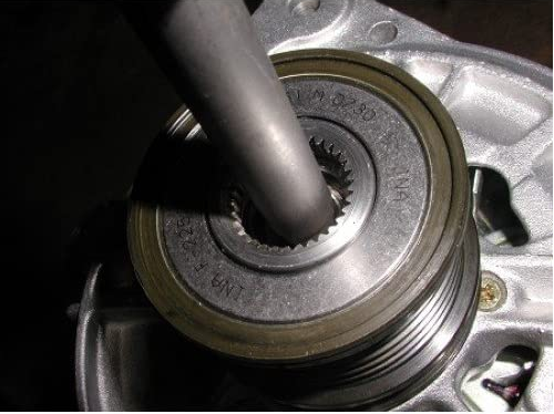

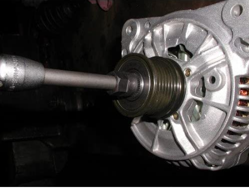

it looks like it's sealed, but I did squirt some wd-40 in the crack where it ratchets trying not to get it on the belt grove. i need to order the splined tool from amazon to actually remove the pulley. here's some photos of the tool and the pulley from amazon. its an 8088 Bosch alternator wrench.
the pulley has a double spline, one on the shaft and another inside the pulley. dam these German engineers!!
