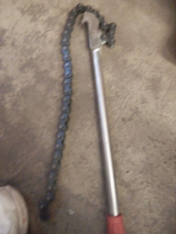

Hey guys, I couldn't find info on the install of the spin on fan clutches. The torque of the engine tightens them up but do you have to use the tightening tool to get a specific torque?
Once you use an air hammer with wrench adapter, you’ll wonder why you went without it. No holding anything. Quick BRAAP and it’s loose to spin off. Same install. Spin on, place wrench and quick tap of the trigger.
If using a big crescent wrench, just give a few smacks with a hammer on the end of the wrench.

A well placed machinists prybar through the pulley to hold it.
I used a chain wrench
Very frugal ideas, thanks guys. Except maybe for the air hammer, but I love those. Everyone should have one and they last forever. I've never seen a wrench attachment though! I'll have to look in to that.
Do you mind if I add those ideas to the article?
