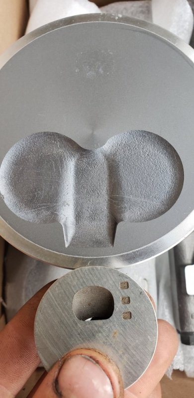

I only stock 6.5 standard bore, but i can machine any set someone sends me. I have 18.5 & 18.0 with valve reliefs in stock, 880.00 shipped, they have my 3 side coatings as well.

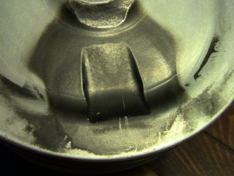

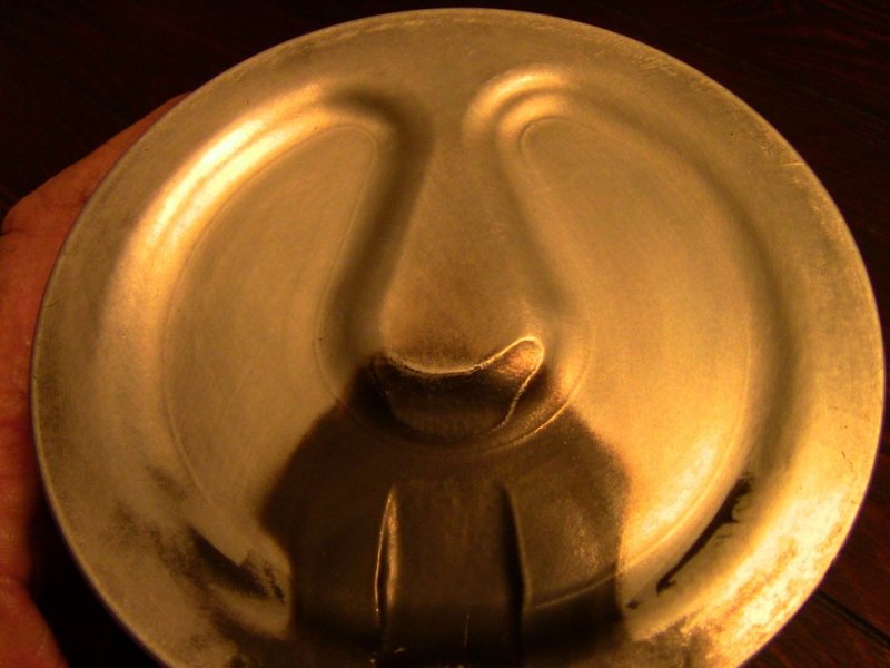

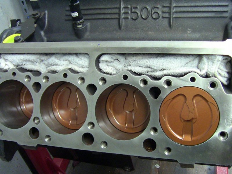

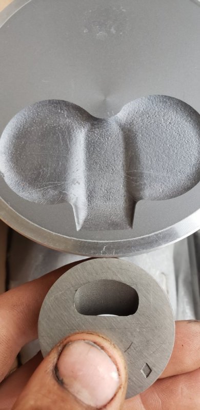

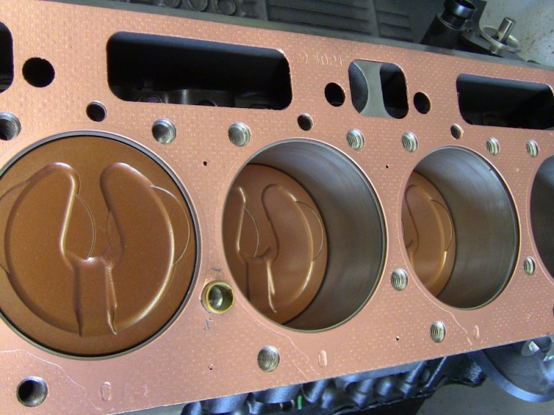

You can see on the original carbon burn marks on the edges of the mickey mouse ears of the piston. On Chis’ piston you can see it tapers off. Looks to me like it allows the flame front to blend across the piston better than the factory without loosing the inrush and outflow of gases through the precup directional channeling.
I went from 21.5:1 to 18.5:1 flat cut pistons many many years ago and HATED it. I blamed all the performance loss on compression loss until we swapped them out for some 18.5:1 that had the top made normal. It was the gm engineers that showed me that back in the 90’s. They said the mickey mouse ears were to spread the flame front out to the sides instead of across the top to the other side. The extra channeling in Chris’ piston will just give it more low area to flow out in and the high sone still in the center keeps it from going across.
If you look at the precup of flat cut pistons you’ll see carbon wash on them too. That stupid little divit is so crucial to get air flowing in and out of the precup. It’s like holding a water bottle the right way under the sink instead of dumping water from a bucket onto the bottle. It’s like a funnel.
