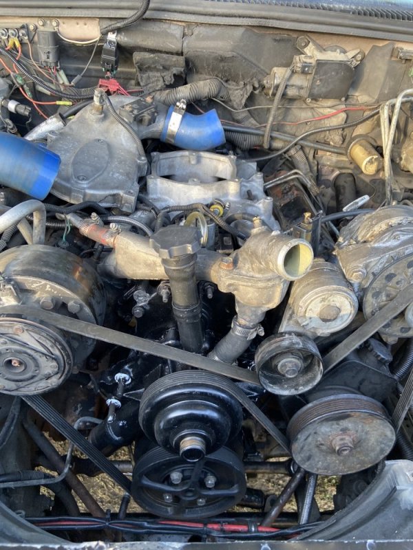

The intake manifold fought me going in. A wire and return line bracket got under the passenger side rear. It’s in now. All that’s left to do is the upper intake, fan shroud screws at the joining section, coolant, skid plate, alternator bracket bar. Also fuel tank skid and strap that my son left dropped.
