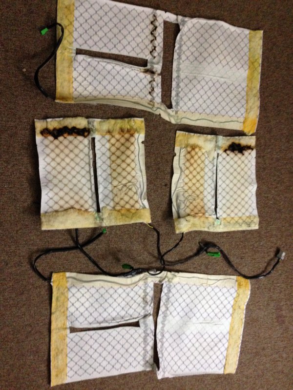

Well today was the day. I ordered both bottom and top seat heaters for both front seats. Getting cold out these days and I couldn't put up with it anymore. I ordered Dorman heaters off Amazon.
Hmm Mike. Guess I could have taken a few pics along the way. My bad. Here is a pic of the elements that came out of the truck. The date on the elements say June 25,2004 so I guess they are original to the truck. Not bad.
Can anyone guess which one is from the drivers seat?
No Tanner, the replacement elements are the same size. As for the burned areas...yeah it looked real bad when I pulled them out. The leather was burnt on the inside of the seats. They lived a good life. Nice to have warm seats again.
1 less thing that doesn't work on my truck LOL.
