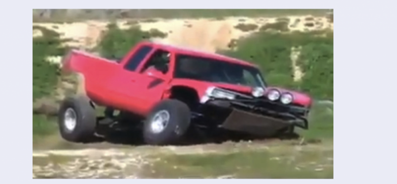

I agree it doesn’t look good. But I know where it comes from- off road racing. The weight of the engine is killer when landing jumps, and even repeated high speed woops. You simply have to have way more suspension travel in the front axle than in the rear.
Many of the multimillion dollar race trucks with the fiberglass bed sides and rear, 3 separate panel pieces (strictly for appearance) have been being built at a different angle and are actually much shorter in the rear of the bed than front of the bed in the last few years to give more of an appearance of being closer to normal because the manufacturer sponsors (gm, toyota, etc) want the fans to envision that can be their truck and go huy a new one.
In So Cal, Nv, Ut, Baja Mx, some of Az- There is tremendous racing circuits for off road cross country. Later this turned to arena racing basically for more profitability. Now there is places, even one in little Boulder City just over the hill from Vegas where you can pay to drive million dollar trophy trucks for fun.
While the top tier trucks with no actual bed and tubular chassis can fake the look into being almost normal, all the actual trucks that most the racers drive and all the regular guys that make their DD pickup capable of ripping across the desert at high speed have a choice to make. Go with nose high build, or end up like this picture. The younger crowd Has seen so many of the amateur level trucks running that they accept this is the look of a well built off road racing pickup.

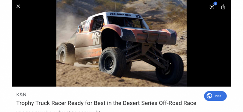

One of the other ways the way expensive trucks are getting away from the nose high set up and having great front runners end travel is really long a arms. This pushed the front tires way wider than the doors of the truck. There are many trucks I’ve seen in person and sat inside but when you see pics of them it can’t get noticed. Here is a pic of a design that doesn’t try to hide it but show it off for what it is. Often the rear fenders get over flared just to match the front - like the rear would only need 6” offset but they go 10” to be closer to the 12”-14” wider the front fenders are.
I LIKE THAT.
@Will L. , I agree 100 percent about the off road racing trucks, I've watched some of that racing, that's cool. Takes some pretty good driving skills to operate one of those trucks.

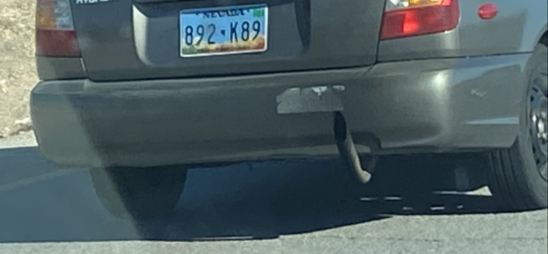

Just now driving from Vegas to Boulder City (20 minutes) I saw this: not pro level like the video, but made me laugh.
