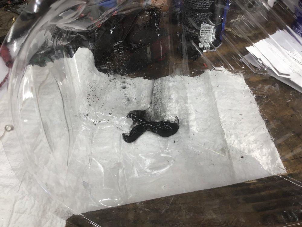

The first one I didn’t let it run long. Maybe got a half can of freon in after I pulled the system down and checked for leaks.First thought it was the clutch and coil causing the noise but when it drained the oil from the compressor and there was a small amount of black oil mixed in with the rest of the oil. That’s when I decided it wasn’t the coil bearing making the noise. Pulled the orfice tube and it was luckily clean. May it didn’t get to the condenser. New Evap. and condenser, dryer and orfice. Got a new compressor warranted from O,Reillys and made them give me some flush and the flush tool. Had to repair the flush tool because it leaked.🤯 Flushed the system ( it wasn’t very dirty) and pulled it down, jumped the pressure switch and it too started screaming right away WTF🤯.
Both of the compressors came w/3oz. of oil in them and I topped them off at 8 oz. the required amount as per the paperwork.
I let the second bad compressor run longer getting almost 2 cans in while trying to figure out what’s going on. In the above video the belt was chirping on start up without the compressor running and went went away when I disconnected the vacuum supply to the boost switch. Then when I jumped the ac switch it got louder. Strange🤔. The second video below is after I ran the compressor longer and the chirping turned to screaming. Pulled the compressor again🤯 and the oil was a lot blacker but there was less oil compared to the first compressor. I did let it run longer so maybe the oil did get to the condenser. Both videos are of the second compressor only. Anybody have any problems w/ Murray (Four Seasons) compressors? Any suggestion on a different make of compressor they’re probably all from China. Maybe I’ll try a rebuilt one. Thanks guys.

on and the belt isn’t flopping. It was free wheeling I wasn’t trying to charge it at that time but it still wasn’t flopping and the previous tensioner was on there. I definitely need to figure this out before the next comp. Installation. Going to check the belt routing. I was using the belt diagram from the red 95 C/K manual but I do remember having trouble. I ll have to recheck. Maybe put the previous belt tensioner back on. I do believe there is a belt problem causing all that noise but would that cause the black oil come out of the compressor? There was not a lot of oil in there compared to the first comp. I believe unfortunately the rest is in the system because I ran the comp. longer.

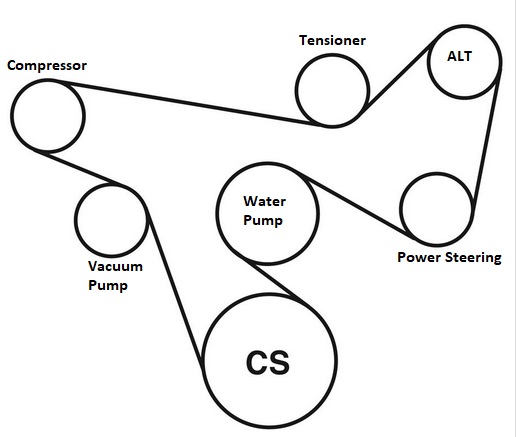

Do you still have your factory GM belt tensioner? the pulleys on the auto parts units are narrower, not sure on the diameter though. what is the part number on the belt you have on there. I have seen where some auto parts catalog's reference the incorrect belt. Belt should be a gates K06120HD or a 102" 6 grove belt. There is a gates K061015HD which is a 101.5" 6 grove belt shown on RA that also fits a 95. I assume that comes in if the alternator has ever been replaced and the owner didn't save on the original pulley which is larger diameter for the tach to read properly.
When you have the belt off, check all the other pulleys for resistance. the only one you will have a slight resistance on is the vacuum pump but it also should not be very tight to rotate by hand.
Here is the belt routing for the 95
One thing I forgot to add is check and inspect your crank pulley and balancer. if the rubber is wearing out on the pulley, but hasn't given way yet, this can also cause a belt to bounce around too.
