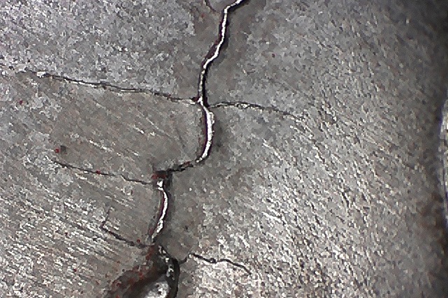

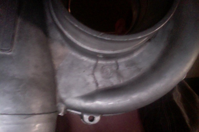

I have a 99 GMC Suburban and I have fallen victim to a cracked block (DOM 3/99). I have pulled the engine out and I am cleaning all the parts that will bolt onto my new P400 that is on order. While cleaning the parts I noticed 2 cracks in the turbo housing (pictured). This is a stock GM8 turbo that I just ordered a Wicked Wheel 2 for because I have spent to much money as is and I'm trying to not spend more. I have come to the conclusion I need to get a new turbo (can I weld it?). I want to get opinions on my specific set up as to the the options I have. So far I'm noticing the A Team Turbo and the HX40W-II w/down pipe adapter (any others). I understand the boost pressure is high with the HX40 but that may or may not be a good thing with my setup. I have read forums for a while though this is my first post.

Paper weight that turbo and return the wicked wheel or ebay it.
Between those two, I would do the ATT. Loosing the wastegate will help you dump heat much better. The hx might later need a cac, but not the ATT. The only advantage the hx would have is it might spool a couple hundered rpm quicker, but the $ saved on ATT cost and no cac- you can buy a qsv and have it all.

QSV $700, nope lol. I'm at the way end of my bank account. Right now, because I have a prosumer shop in my garage I have determined the 2 least expensive ways for me to be up and running are to either tig my cracks, install the Wicked Wheel 2 that I already paid for and move on or return the WW2 ($160) and buy the HX40wII off ebay for $260 and fab my own down pipe adapter. After all my research I would prefer the ATT but it is what it is and I can change it later. I did order new motor mounts, but not the tranny. The oil pan is from Heath. No matter who you buy the engine from it comes from AM General direct unless you are having it modified like Leroy does. AM/GEP wont install gapless rings or aftermarket rockers.
