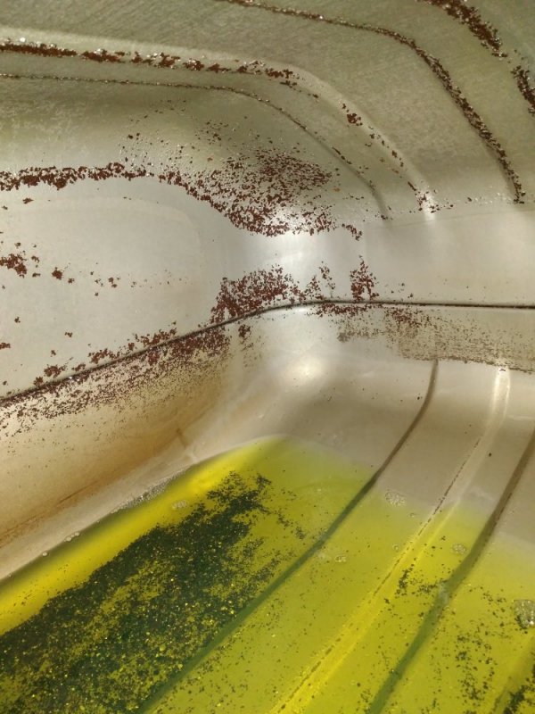

@WarWagon - paint flake and corrosion; possibly some grit. No obvious water or biologicals. Overall, it's in surprisingly good shape for being 26 years old.IMG_20200924_192005[1].jpg

Given the picture IMO the fuel is fine. Not sure where the sand bar came from. Is it magnetic? In this case I suggest replacing the lift pump as it's scored up bad, flush the line from the FMM to the tank, and dissemble the FFM to clean it out. The heater has to come out to clean the dirt out. You will need new O rings.
I wouldn’t out the lift pump yet. Get a gauge on there like should have been from factory. Tap it at the ip inlet in metal fittings not rubber hose. Mount the gauge on the dash so you can see it while driving. If it is low pressure, then replace it. If not run it. Descent pumps are hard to find and if you chuck a good one over maybe it got damaged- that could suck. FTB- Get the line up to 3/8 while doing it.
Do loose the sock and get a spin on filter pre liftpump.
Examine the rest of the fuel line while tank is out. If rusty st all- replacement now. Any rubber line should be sae30r9.
