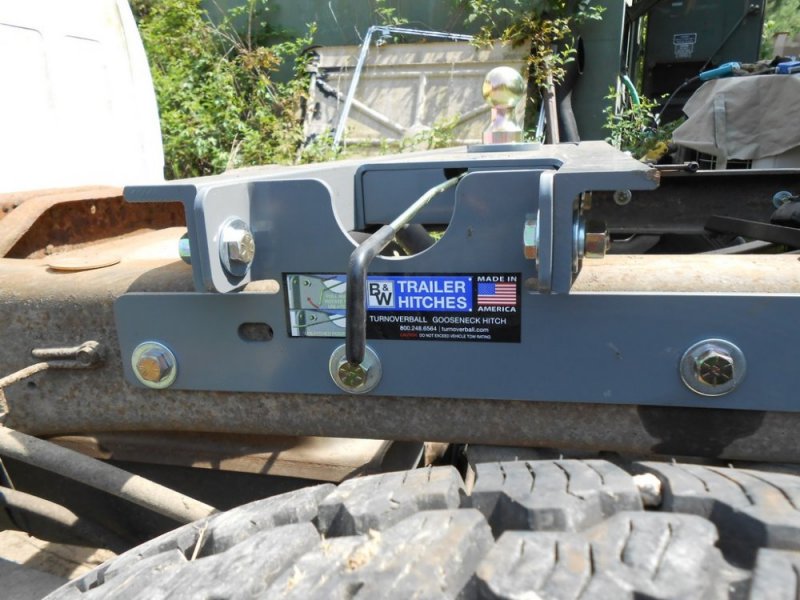

I've been using a B&W Turnover ball hitch for gooseneck pulling for a while. I like it. I added some additional mounting bolts in the frame mount to fill some available holes that were there. This pulled the mount snug along the frame rails. The bed was off due to damage from an undocumented, unlicensed or insured visitor. That made things quite a bit simpler at the time.

Pics for your viewing. First, the base turnover ball hitch. Which they instruct you to use the mounting holes at the front and rear of the frame plates. I added additional bolts in two of the center holes that are provided.
