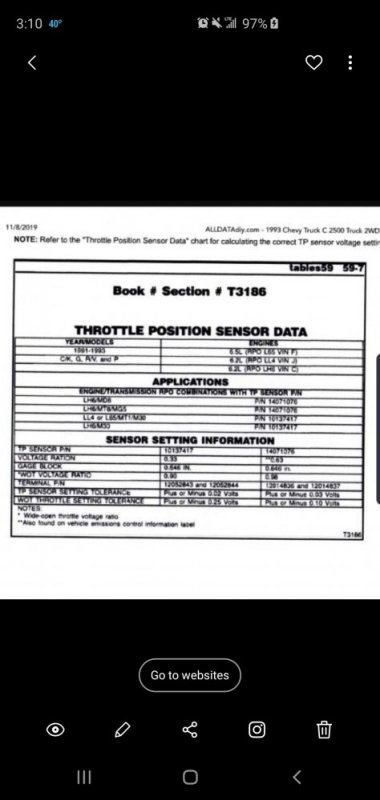

Would anyone be able to tell me the setting for my tps on my 93 k3500 Sierra 6.5 turbo 4x4? I can only find it for a c2500 2 wheel drive. The shop that put it on dropped one of the bolts... which we found so the sensor was able to move. I didn't know that when my roommate looked at it and he just put my new one on. The shop has also been sold so we're having to fix it now. The picture I posted is for the 2500.
It's the Same procedure I posted here for you. Volts n all... There are other ways to do it with special tools, but, Easy button.
