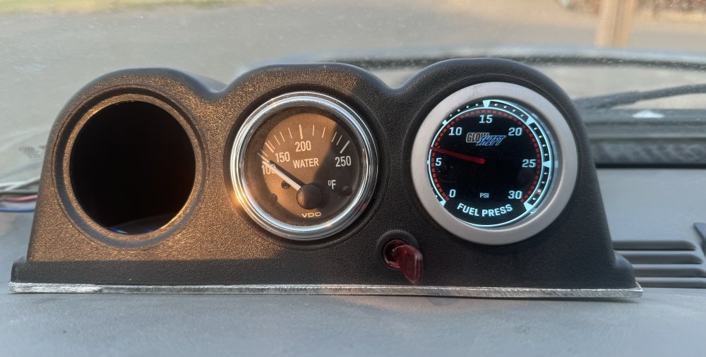

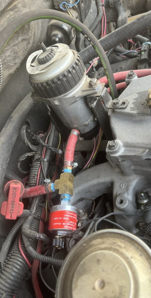

Started the truck, observed the fuel pressure. When I first installed this GlowShift FP gauge and sender unit the FP was running 9 PSI on the Carter pump and relay system from Leroy Diesel.
I didnt have the gauge hooked the first go round of when the engine seemed to die.
Friday morning though I noticed that the FP was running about 4 pounds.
Just what the FP was when the engine did stall I did not have a look at the gauge until I got it fired up again, about 4PSI.
While the truck was idling at the house, there is absolutely no air intrusion in the clear plastic hose.
