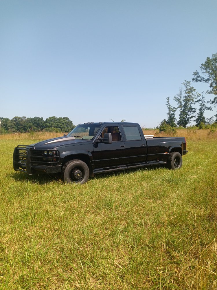

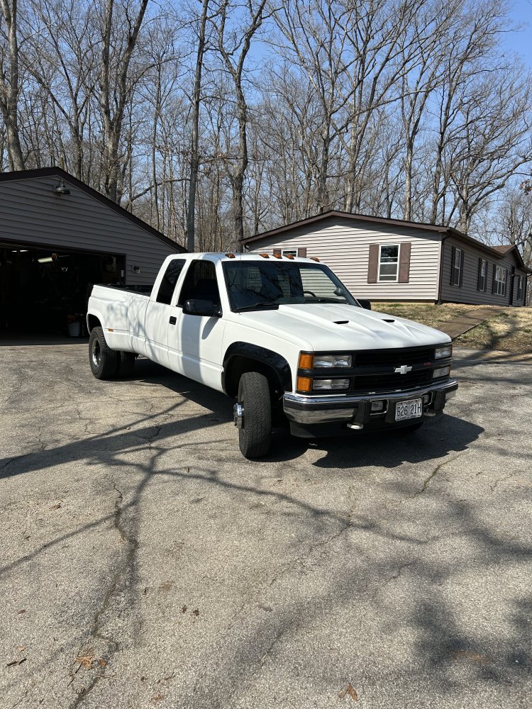

I’m getting ready to get new tires on my 95’ Duelly. I would like the rear tire to stick out a little and fill the wheel well a little more. Not too much that it would rub. Would not be apposed to to spacers and what would the spacer width be. Also wouldn’t be apposed to a different size in the front. 245/75,s on there now.IMG_1185.jpeg
Spacers between the duals will help with wider tires. are you wanting to go taller? I run a 265-75 on my 95 truck. it sits about 4" taller, enough you'd want to get some steps.
Here is a good site to compare tire sizes. I use it along with an online RPM/ speed calculator to figure out how different sizes change your RPM and speedo. remember your 4l80e ratio in 3rd is 1.00 and 4th is 0.75 torque converter open and locked up also makes a difference. on average add 200 rpm for when the TCC is not in lockup.

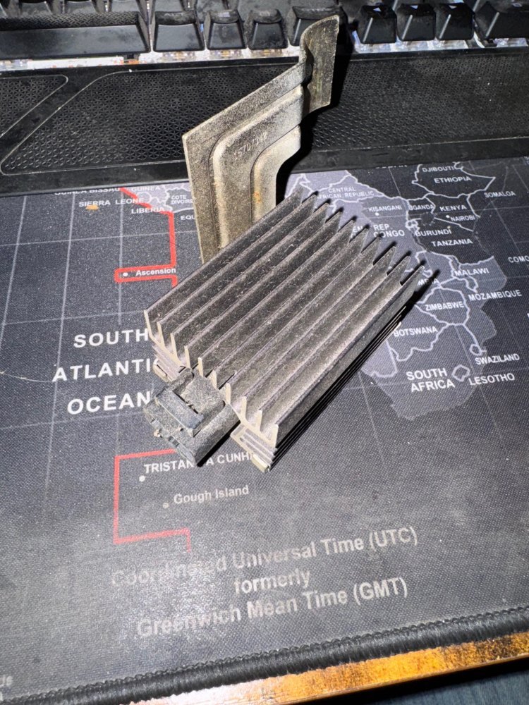

I have one that was mounted on a replacement dash I installed on my truck. IDK if it works, but it's yours if you want it. Here is a pic of it to make sure this is what you need.
Yea, d I’m not going to run DRL,s. I’m not sure i have them. That module doesn’t look anything like the one i thought was a my module. It’s a plastic case w/a circuit board the size of a flip phone right behind the headlamp switch. Does all four bulbs come on when you have your hi beams on? Mine don’t, just the two inside bulbs. I though all four bulbs should light. Thanks.
