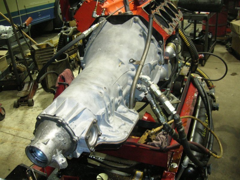

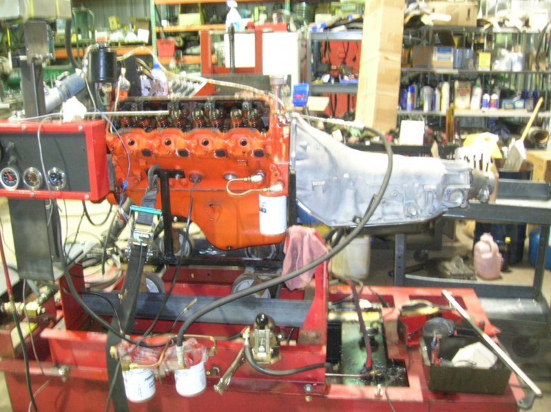

The test stand help me keep sane when puttering with the junk I love to putter with. The transmission provide load when torque converter is engaged, unit is locked internally, saw 5 # of boost several times at less than half throttle, then I saw the bubbles coming out of the head/block parting line @ # 7. Yes it was time for gaskets.
Mr. Hipster,Glad to see you ditched the wrong head bolts, and reusing the 1 already stretched and no good head bolt for the missing one would have failed, no doubt about it. Before you go any further, I suggest starting a thread of your own , describing it all from the start and where your at now. Why, other than a cool record of your own truck build, We would have stopped you from using those gaskets. I am willing to bet you cant find 2 people with the 6.5 that used cometic gaskets and got 100,000 out of it with out the heads coming back off. Victor rienze, or Felpo. possibly +10 gaskets depending on how true the head and block are, what boost your running, and so forth. The is a supplier here, Leroy's Diesel, that I believe would have beat the price you paid for ARP head studs.
That's a good test stand you have there and I like the oil bypass line you made, but hope your intent for that is stand only. Make sure to put in new oil cooler lines when it goes back in the rig. These engines will not last with out the cooler, and a blown line wipes an engine in a heartbeat.
