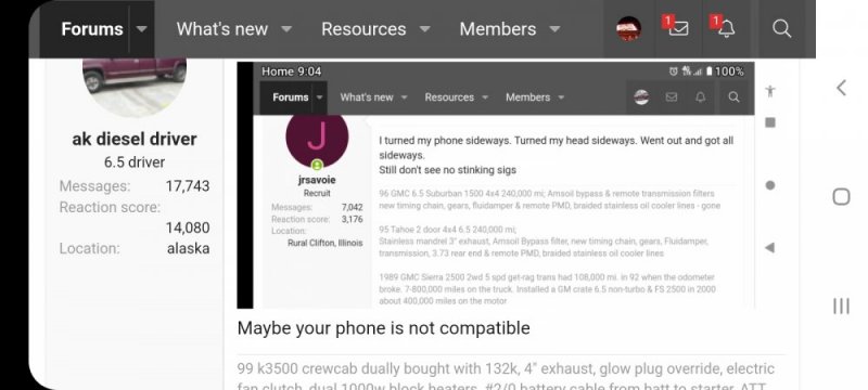

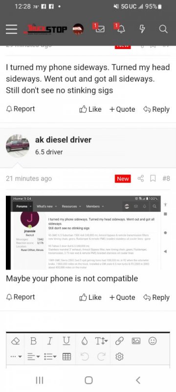

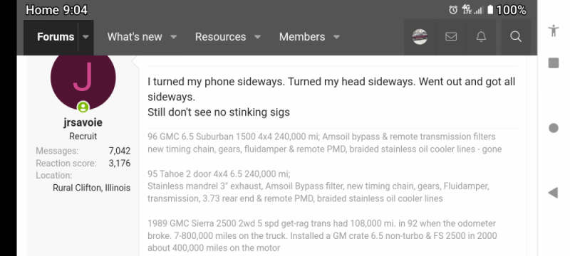

I had to go scroll up and check. I dont see the sig. line in My posts some more now. Seems I used to be able to see it.
Guess the forum software might have changed so that the owner of a post dont see their own sig. linesz 🤷‍♂️😹😹😹
Quite possible. First photo is sideways (Landscape) second vertical (Portrait). Landscape shows site stats and signature, Portrait doesn't. My phone is an Android OS Samsung Galaxy A32 5G.Screenshot_20220605-122757_Samsung Internet.jpgScreenshot_20220605-122816_Samsung Internet.jpg
It all depends on the browser and how up to date your phony is. there are a lot of so called newer phones out there that use yesterdays updates. I have found on several android phones they use random default pre-installed browsers. it all depends on the manufacture and the service provider they came from. example is Samsung phones and tablets that are from att they package the operating system with their apps and bloat ware that seems very annoying to lots of folks.. usually if I have an android tablet or phone, the first thing I do is root it or jailbreak it as they call it and ether remove all the crap and install what I want, or search for a custom operating system that was built from the base stock android os and not touched by any of these companies.
