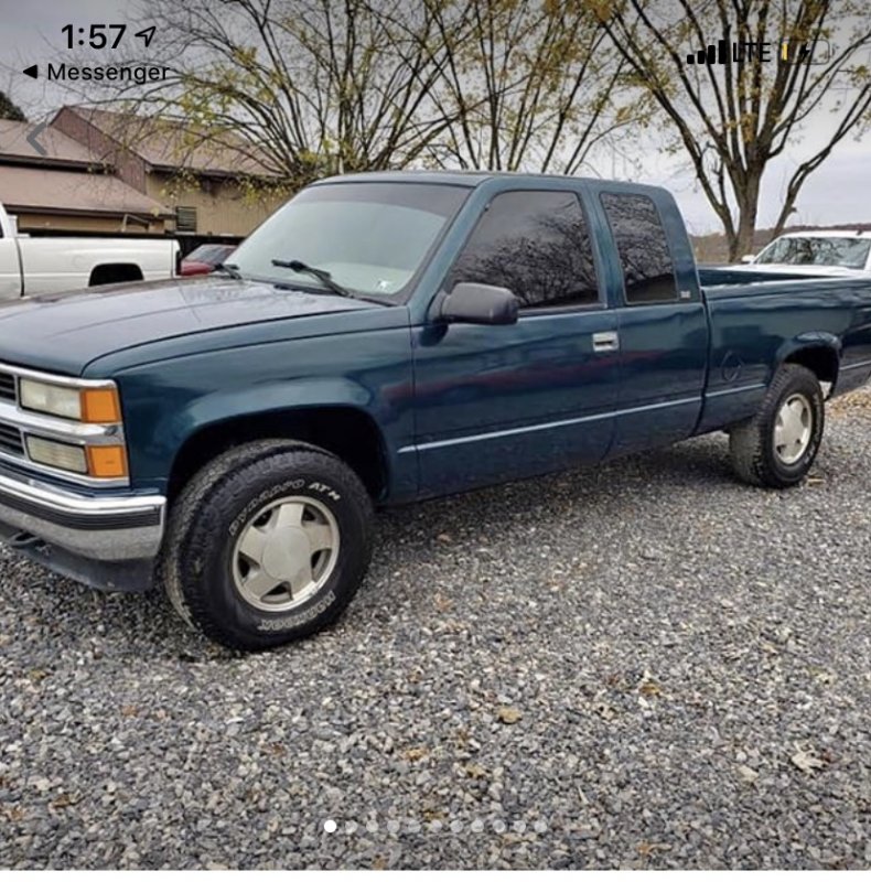

has anyone put a 6.5 in a k1500 I want to put my 6.5 engine in place of my 350 but I don’t want to swap out the front end and stuff for heavier duty stuff will the truck hold up with that 6.5??

There are 1500 made with the 6.5.
The springs are heavier because of the added weight. I never compared anything else in the front end.
Make sure you are legal to do the swap by your local smog laws.
