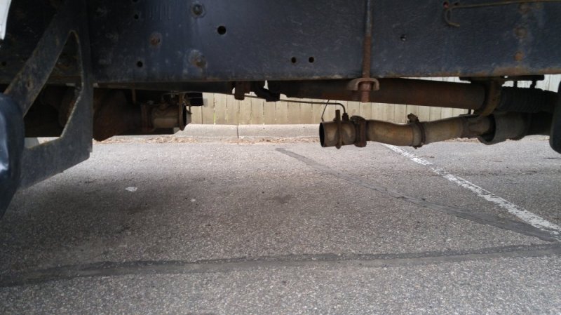

So the DPF was stolen off the 08 C4500 sometime in the last couple days, noticed it in the lot this afternoon. The rear chunk of exhaust is hanging on both ends, and the cat is still there. Will it go into limp home mode without the DPF? Who is the best tuner to delete the emissions stuff? I have no reason to spend the money to put a DPF back on... @THEFERMANATOR
What else should I be looking for to see what's damaged?

Make sure to get pricing on "maybe" entire new exhaust while its in the shop because they damaged hangers and got metal debris into muffler....
Quick estimate just on parts was $4k, dealer is going to get me a full estimate, managed to drive it over there without any complications (truck didn't even know it was gone!).
