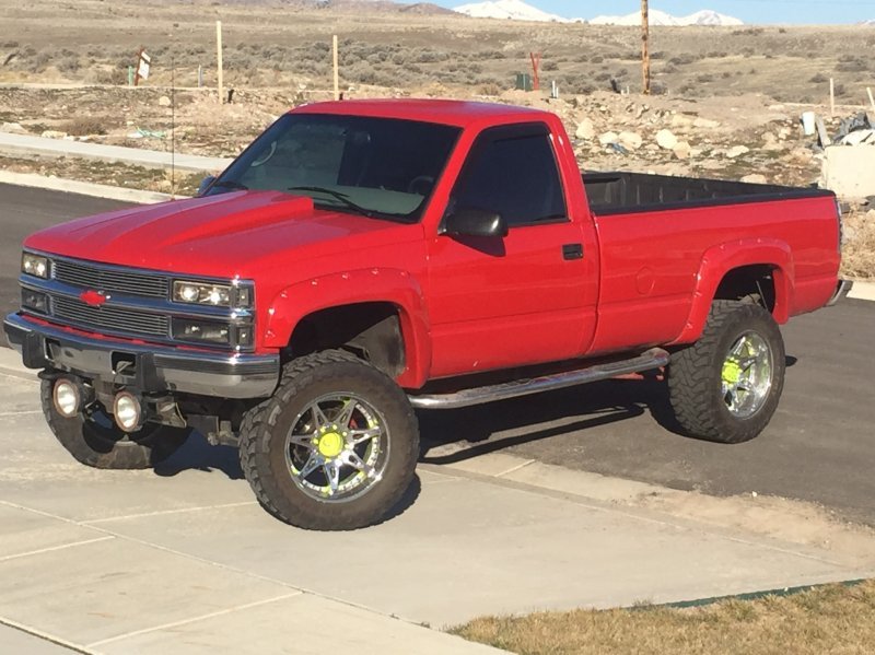

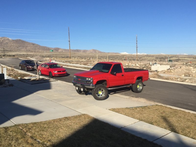

SSForce (Steve) came by to visit and play around. He’s had a set of injectors he wanted to swap in as well as try out my A-Team Turbo (the easiest bolt on upgrade you’re bound to come across) as well as install his self-sourced Feed the Beast mod.
He dropped the truck off the night before so we wouldn’t be working on a hot-hot-hot motor. I pulled it out into the sun for a couple of happy snaps. It was good to light off a 6.5 again and it was in good company with my VWs (TDI) and my truck on stilts in the next bay as a warning to behave.

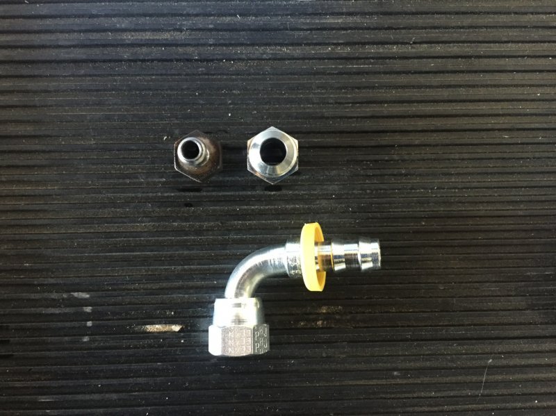

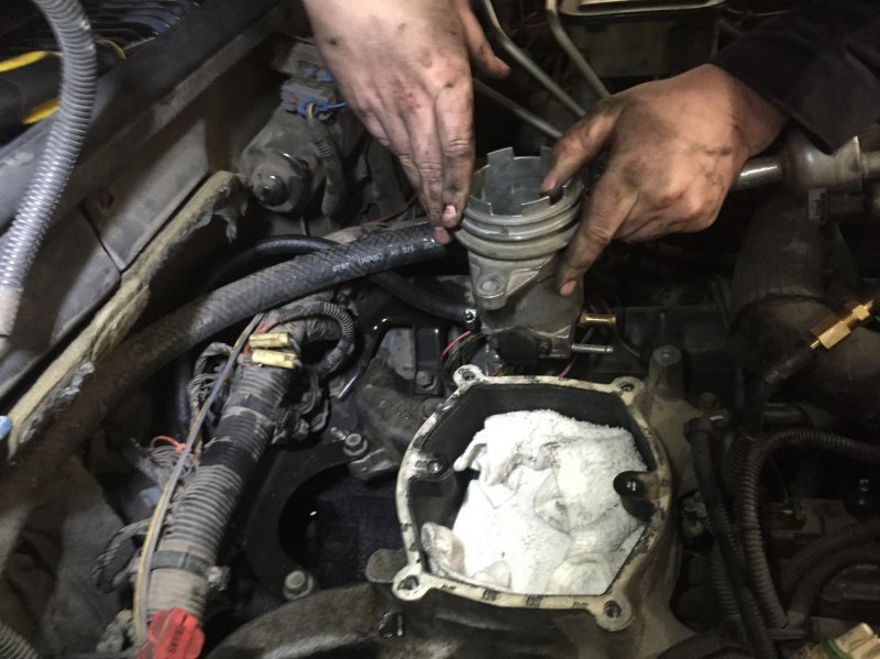

Feed the Beast went on first(ish). He’d picked up the parts locally. Hose; IP inlet fittings (90*) and the adapter to the IP; FFM outlet barb and brass T so he could hook up his fuel pressure gauge sender pre FFM. Didn’t drill out the internal IP inlet screen thingamabob as we were: 1. Chicken; 2. No Drill Press; 3. No Carbide Drill Bit and 4. Chicken (yeah, said that twice…there was two of us). Put it on the TTD list.
To get around drilling out the FFM by hand, we swapped in my FFM which is already modified with the 3/8” barb and I took his new barb and old FFM minus the WIF sensor. Mine had a cooked wire so we swapped that out instead.

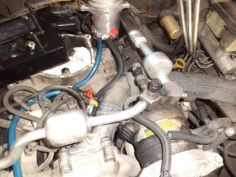

Originally the plan was to pull the lines under the lower intake but Steve decided to ‘Remote’ the FFM to the DS of the Upper intake. The 10mm threaded rods I purchased were too short to work by simply elevating the FFM in the back but we found another bolt hole that was working was working until we discovered Leroy’s ATT adaptor was in the road so we made provision to use 8mm Stud off the back DS Upper Intake bolt hole. That failed too but more on that later (cliff note: Strike Two to the ATT Adapter).
Here's Steve checking for fitment on the alternate side.
You can see the old and new line reading to be pulled under the lower intake.
We also ran the T Valve drain line around the front of the intake using some of my old Air Dog install kit’s ¼” return line (another lovely parting gift).SS Force 08-s.JPG

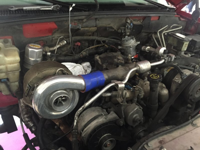

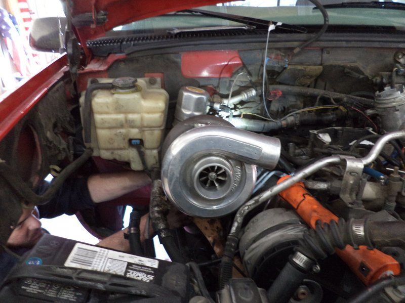

HX-35 / A Team Turbo swap. Why? Because we can. Steve loves the HX-35 though he’s concerned about the boost as his motor isn’t studded and has a few miles on it. All the ATT talk has given him an unhealthy case of ‘Forum-itis’ so he wanted to give it a run. Easy do, HX came off for the injector swap anyway and the Heath Tune should prove to be a fair match to it. I’d pre-installed 3/8 16p studs and one of my cut back oil return line fitting to make it an easier install.
Steve pulled the fender well and flare to make access to things easier. We needed the room to get at the bolts holding the HX=35 to the exhaust manifold. He said he couldn’t remember how he got the HX on there was so little clearance for the inner and front and back bolts. (I got an HX-35 12cm on the shelf for the hell of it and it’s going to F’n stay there I can tell you after trying to get this one out.)SS Force 09-s.JPG
Orange thing is a shop light.
The hardest parts about installing the A-Team was figuring out what to do with all the room we had to work with around the thing; wiping the smiles off our faces; and getting the upper intake aligned and that had to do with fitment issues with the Adapter Spacer (the ONLY hard part truthfully). I’ve seen them installed on three trucks now and none of the owners were happy with the CDR oil blowing out of upper and lower mating surfaces despite adding RTV. Mine was the third and 635 put it on his truck and had the same issue even though he let it sit for a few days to le the RTV setup (Strike 3) I understand it has been upgraded so ‘Your Results May Vary.” Anyway, for a “try it and see” for the ATT test, it was worth the usage. When we went to install the Upper, it was then that we discovered that on SSForce’s truck, his A/C lines made the whole thing moot as there wasn’t clearance. We needed another half inch before the OEM upper was going to mount to the adapter. Not willing to flex the A/C lines, we made do with what supplies we had on hand. Steve had already cut his intake back a couple of inches to make it work with the HX-35 so his longer silicon hose we ‘made it work’ but that will have to be addressed as I’m not confident it won’t blow off. But, he’s venting CDR to atmosphere so there won’t be any oil working between the boot and the Turbo outlet/Intake inlet.

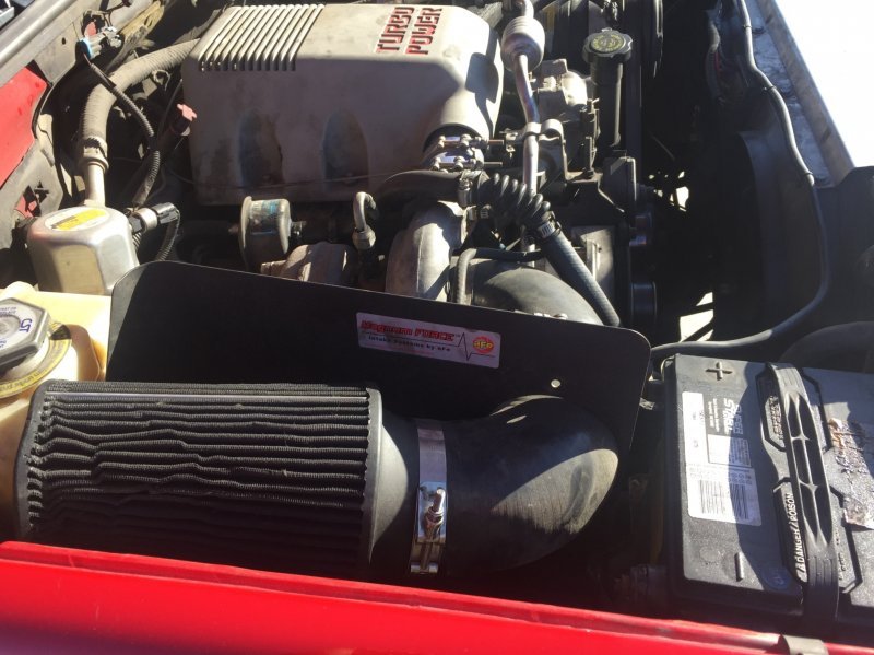

Next challenge of sorts was an air cleaner. He’s running a modified AFE set up to mate to the 4” or whatever inlet ring on the HX but the ATT is the typical 3”. So, the last ‘lovely parting gift (lone really as the ATT is only a trial [for now]) was a Heath Gen 1 air box.

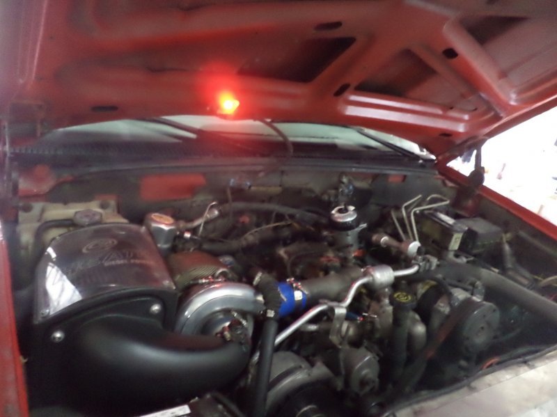

And the obligatory Post Project Pic.
