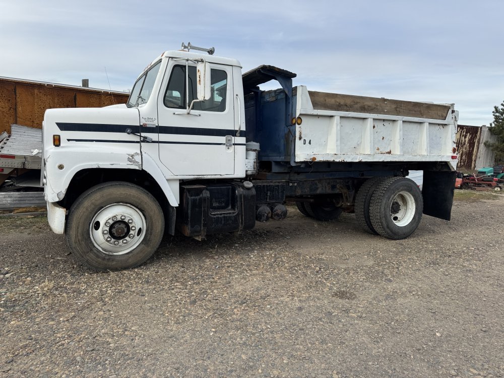

I need a truck to mount my 12 foot dump body on... they're pretty hard to find. I also I want the oomph of a diesel... I have a 6.5 TD in my 96 K2500-- with some bolt on mods it's making about 30 hp more than stock and gets 18 mpg on the road. The 6.2/6.5s are bolt on to other GM transmission and motor mounts, though the radiator and some other things have to be changed.

My old 1991 International 4700 is probably to far and probably needs too much work to consider.
The best I can say is, it was running when parked
