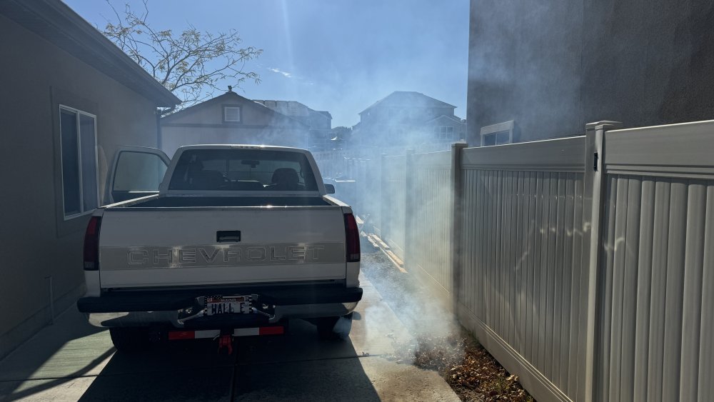

Notice while up in MT last summer trying to be of help to Big-T that my first starts were starting to have a little smoke. Hmmm Acrid diesel smoke that cleared up quickly as engine came to life.
It was kinda hit and miss up there but, when it ‘hit’, the smokewas getting a little worse. Longer in duration.
With the colder weather setting in, the smoke has gotten thicker and, as the engine takes a little longer to get happy, the duration increases. Smoke lasts for no more than 40 seconds or so…so far.
While smoking there is a noticeable miss or stutter and, sometimes, a loud ‘fop fop fop’ for a few seconds. Cold Hole?

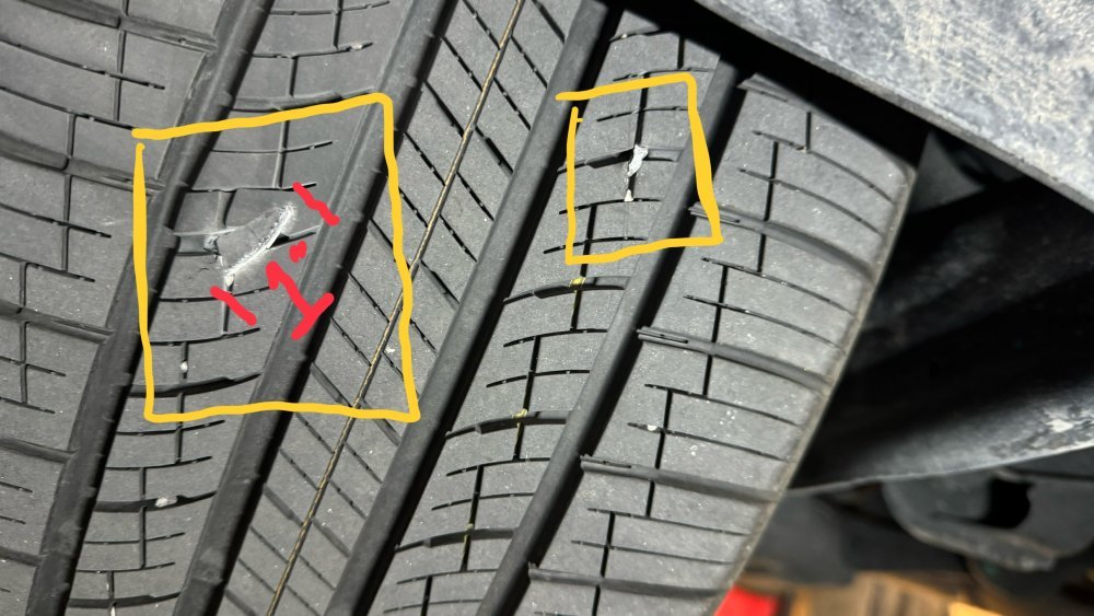

Will probably hit the job Friday or Saturday. Going to pull the inner fender to assist in getting at 4,6 and 8 and assist in routing in the new harness and me shoulders and wrist are still fighting back after the fall down the stairs a couple of weeks ago. Glad this isn’t my only available vehicle anymore. Still, had to replace a tire because I picked up a construction staple (red) and two dry wall knife blades (yellow).
Ended up replacing all four…only 3200 miles. They were Nextel’s (S. Korea) and came on the car. Didn’t like them anyway.
It was time to get snow tires anyway so, decided to get the Michelin Cross Climate 2’s like I had on the old Touareg. 3Peak Mountain rated, great snow tire and pulled me through deep mud too.

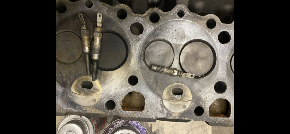

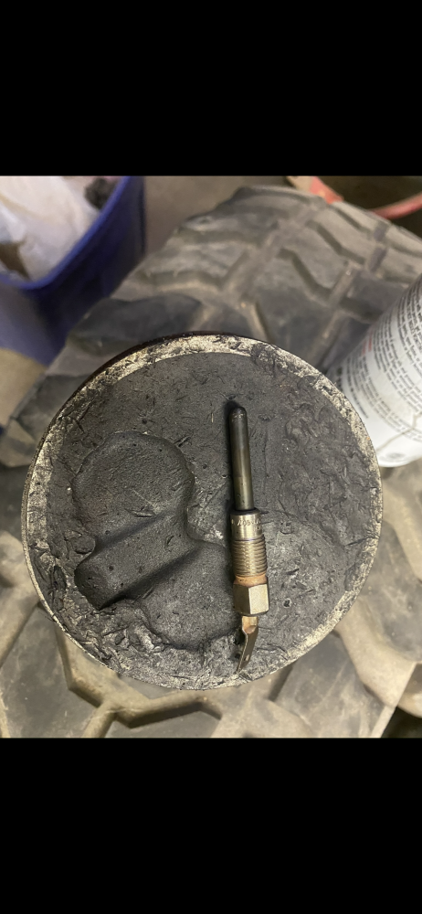

IMG_1941.pngIMG_1943.pngOn the PLUGS not having problems lately-because you aren’t hearing enough people still making the MISTAKE OF BUYING them.
It has been exactly 2 weeks to the day since I walked someone through their problem in a 6.5 hummer who had issues with a set he bought the week before. He had the problem of the tabs breaking off.
It has been about 2 months since the guy before that. His popped an element of just like mine did. When his rattled hard he panicked and shut it off. His element was in the precup until he tried to grab with pliers and bumped it into the cylinder. He is a surgical nurse and after fighting it 6 hours walked away. Brought home some thin surgery locking needle nose looking thing. He got it out with that after a couple hours.
You’re a big boy- you make your decisions. Do the math how much a set of delcos cost and cost of the bosch to throw away & I just remind you of my optimizer with under 70,000 miles looked like this:
Piston and precup trash. I never looked if the valves bent yet.
