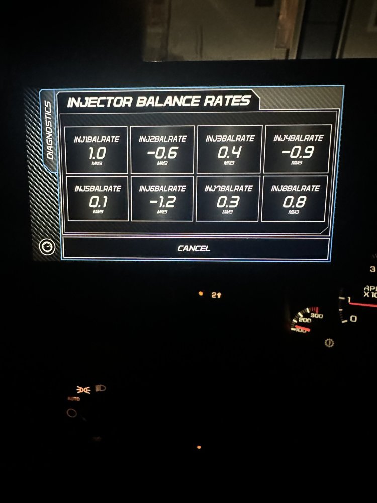

Smoke on Cold Start-up
I know nothing about duramaxes but 17 degrees is cold for a diesel any way you slice it. I also don't know how to interpret balance rates let alone what "normal" is. I think @RI Chevy Silveradoman has a similar year truck, maybe he can offer some firsthand experience
Is the truck running fine otherwise?

Running fine. Owner just wants to ensure longevity.
A few thoughts I have:
Cold diesels will emit some smoke/steam. It's hard to tell from the video how quickly the smoke evaporates. If it evaporates quickly, I would consider it steam rather than smoke.
The LBZ has an intake heater. If that's not working it could affect smoke output. Although I would expect a trouble code to set as well.
Worn injectors will start to haze at warm idle, especially after sitting at idle for a bit. But with balance rates like those, I wouldn't be too worried.
