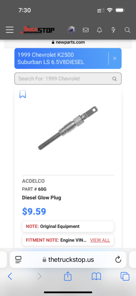

The comment of eliminating the bosch for the AC Delco 60G is 100%. I can dig up picks of my ruined piston from a failed Bosch with under 10,000 miles on them.
Only by them from a proven authorized distributor like Napa. There is a ton of knockoffs around online. Spend the extra couple bucks to protect the engine.

As for buying the gp from an authorized dealer. What's your opinion on RockAuto? And if using NAPA should I buy it at a store or online or is the same?

Your glowplugs are EXACTLY what I had and where I bought them. And I used to recommend them- until mine destroyed my engine. And saw multiple others having the same problem with them from Rock auto, and other sources.
Rockauto is supposed to be an authorized dealer for AC Delco now- but I don’t trust them for it. Everytime there is a problem with RA it becomes a complete mess. So no- I wouldn’t buy from them.
Go into a Napa personally is my recommendation.
