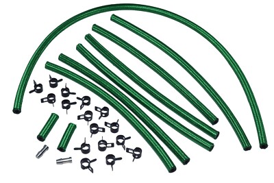

Can non injection fuel line be used to replace the tiny rubber injection lines that run from injector to injector on the 1993 6.5 TD with manual IP?
i orderd from a seller on ebay that is a German made that works without the clamps. From the discription and reviews it was a great deal as long as its what its supposed to be when I receive it. Thanks for the reply tho.
Yes it is low pressure. The gm style line kit is available here: http://leroydiesel.com/products/injector-return-hoses-with-clamps/
I have had good luck over the years using the line from Mercedes dealerships, but most the stuff online has high failure rate.
Yeah, the german made hose is the good stuff, problem is unless you paid $5 a foot, you probably will get the knock off cheap crap that fails in 2 years. Hopefully yours is good.

well the injecters are leaking already. it seems the line I bought on ebay stops sealing after it gets warm and possibly fuel additives could be part to blame. I am now replacing and tracking down leaks that only leak while engine is running. I disconected the hose on the IP and routed the pressure line from the LP to the return so i could pressure the return lines without having to have the engine running and found 2 leaking injecters that were leaking at the tiny metal nipples whare it looks like they were bent from socket not fully seated upon instal or removal. I changed the housings out and now the returns are leaking. is there supposed to be a tiny rubber seal that sits onto of the injected ware the feed line balled tightens down?
