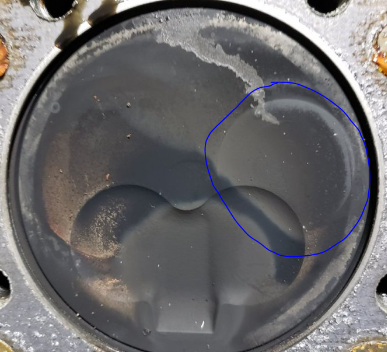

I have this Optimizer block, not a P400, so I'm not going for crazy numbers. If I was going to swing for the +$1700 forged crank, then I might want to push my luck. I guess 1.5 ratio is the stock configuration. TSP is using a mixed ratio on his P400. Others have used 1.6. How should I determine what ratio I'm going to want to use?
1.5 stock, 1.6 or 1.7 roller options.
Higher ratio is opening the valve more and risking piston/ valve hitting slightly more.
Timing gears rather than chain eases the fear because of eliminates chain stretching allowing this.

@SnowDrift I'm not sure if valve reliefs would be needed to be machined into the pistons if going to a higher rocker ratio than stock, Chris would be the man to answer that question. I went with 1.6 more or less because it seemed like the middle ground, slight step up from stock but not full limit of the engine. I also had the compression ratio lowered, so keeping in step with adding more air seemed logical to me

@SnowDrift as was mentioned timing gears would probably help with reducing the risk of pistons hitting valves
I think a slightly thicker head gasket could help as well?
Any reason for not having the pistons machined outside of cost? AFAIK lowering compression will reduce mpg but make for lower cylinder temps and prolong engine life as long as you play nice with the go pedal :)
Yes, cost is the only reason.
I'm trying to make a reasonable engine out of this that I can use for a good long time and for lots of miles, but realistically can't be breaking the bank in doing so. I have to keep it within my means. While I'm not rushed, I also don't want it sitting around for years while I piece things together a little bit at a time. I've decided to spring for some things, such as having it balanced, TSP recommended valve springs and some other items, but have to draw the line somewhere.
It sounds as though the only mechanical reason the valve would have touched the piston is due to the timing chain being stretched - is that correct? That is keeping in mind that I don't have a reason to believe this engine was ever taken apart after it left the factory.
